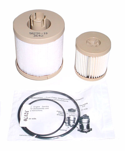

Yes I all ways use motercraft filters the new HFCM is a motercraft PFB-93 6C3Z-9G282-AA. And the only way to get correct filter is to buy a new motorcraft HFCM . Ford dealer checked in to it and told me that Racor witch makes the HFCM and the motorcraft replacement filter . Changed up the filter housing and failed to tell ford. Or has told ford and ford chose to do nothing. See for your self go to ford dealer and get them to pull a new HFCM off the shelf take the filter out of it and compair the filter out of it to a motorcraft 4604 filter. And no ford did not do the repair dealer has serviced this truck sence new and have made all repairs untill now . Oil and all filters changed every 4000 miles 2 sets of injectors and 2 HFCMs before warranty was out has had 3 sets of injector replaced after warranty was out by ford dealer .1 HFCM repacement 4500 miles ago time for yhe service and am doing it my self and that is when I found filters are not right . I will post pic. of the filter
filters
here are the pic of the filters both are motorcraft one with O ring is from a new motorcraft HFCM and the other is a motorcraft 4604 witch is suppose to be the replacement

The filter without the O ring is a 4604 motorcraft I removed the HFCM and removed the fuel pump from it took the 4604 fuel filter and snapped it on the cap installed it in to the HFCM and looked in the hole where the fuel pump gos and it likes about a 16th of an inch of touching where it is suppose to seal the only thing it touches is the cap no wonder my truck eats injector like a fat kid eats cake

Ford dealer has done all filter and oil changes. And the truck has 144000 miles on it and I am tired of the ford dealer replacing parts and not fixing problem. I have had this truck serviced every 4000 miles give or take 2 to 5 hundred miles. Ford dealer replaced HFCM 4500 miles ago. So I decided to do the service my self went to dealer and got filters for 2006 F350. And when I pulled the fuel filter out of the HFCM that is when I noticed that it did not match the replacement. Witch is a 4604 went back to dealer and they told me that the HFCM was a motorcraft that they installed part number 6C3Z-9G282-AA. And when I showed them the filter out of it they tried to tell me it did not come out of the HFCM they installed. So I had them prove it I had them take a new HFCM that has never been insalled and take the filter out of it. And the filter they took out of the new one had the O ring on it just like the one I pulled out of my truck So they have called ford and can not get a part number from them or the correct filter . And if you take the fuel pump out of the HFCM. And put a 4604 filter in it you can see through the hole where the pump gos. That the 4604 filter does not seal it lets the fuel by pass the filter so no wonder these trucks have injector problems fuel is not filtered . And that is when dearler ship told me that Racor that makes the HFCM and the filters for ford must have changed up the HFCM and filter and had not told ford or if they had told ford .Ford had ignored it and had done nothing. And its like I said stop by a ford dealer and ask for the HFCM and look at the filter in it and compair it to the 4604 replacement and see what they have to say
