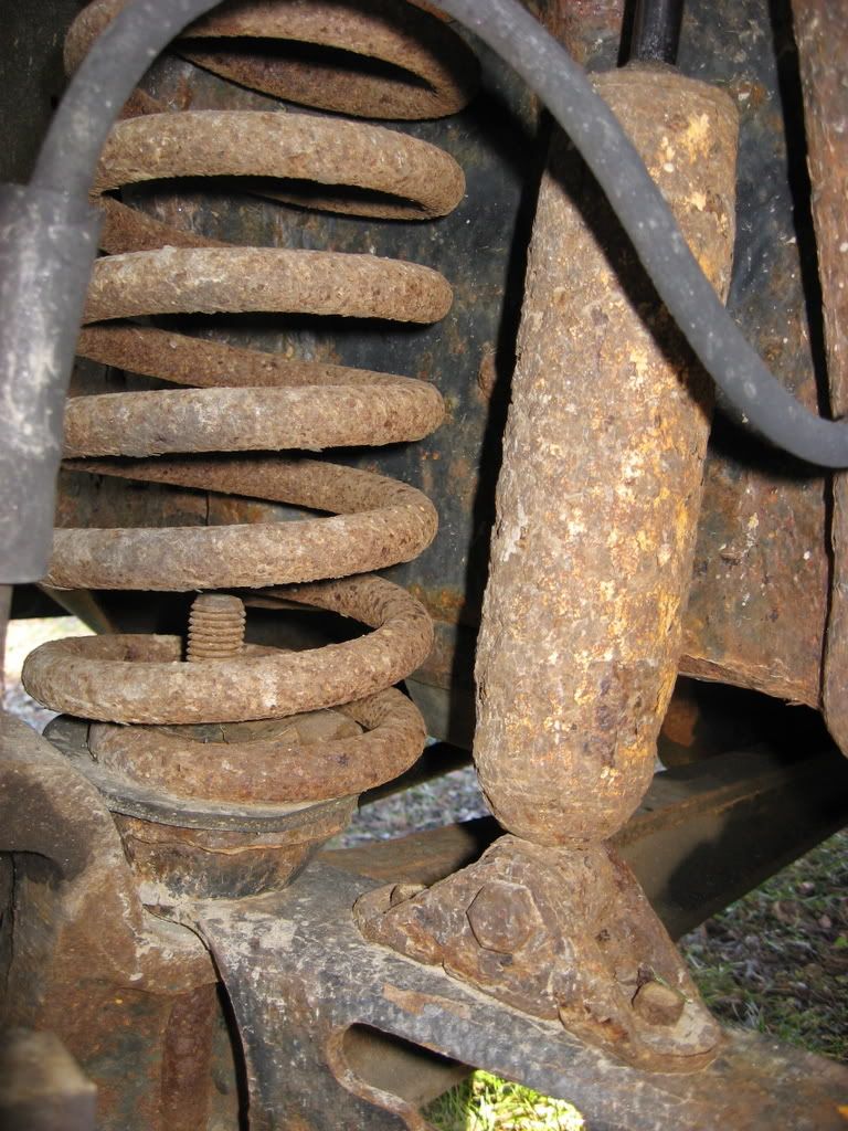

My aunt has an '89 F-150, 2wd that is in, at best, "rough" shape. It is not her daily driver, just a yard truck/dump runner.
I've driven it several hundred miles, and it seems to run and drive OK, but it's really rusty.
It failed it's state safety inspection back in February for ball joints (right wheel only, I believe), shocks and brakes. No mention of rust. The mechanic who did the inspection told her that in his opinion the truck wasn't worth what it would cost to fix with the labor, so I'm sorta getting drafted.
Unless there's anything weird about the brakes on this truck, I can handle fixing them OK, shocks will be a fight to get off, but I've never done ball joints. Given that the truck is rusty...how bad a job is that, what (roughly) would parts cost, and how likely am I to wind up either in over my head (i.e. unable to put it back together) or breaking 47 other pieces trying to take it apart that will then cost a fortune to replace?

It's pretty typical of a 19 year old truck in New England, actually. It was a working truck (she bought it from a welder), never been garaged, 183k miles...
The whole body is rusty, but remarkably doesn't have any holes. I cringe every time I have to unlock the door, though, because the steel that supports the lock is so rusty it flexes when I try to push the key into the lock.

You will need a ball joint press, and probably a torch to get those shocks off. Soak everything in penetrating oil every day for a week before you do the job. Replace all the shock bolts as the ones you have are useless.
Don't use a torch on the knuckle - it's tempered and if you heat it you'll lose the temper and weaken it.
The brakes are easy. I would carefully inspect all the steel brake lines and replace any that are rusty. Yes, this probably means a LOT of new line. I would definitely replace the wheel cylinders and if it pulls when you brake, replace the calipers too.
Air tools would help. You may need a dremel or some sort of grinder if you can't torch the shocks off. Get new shock mounts if you can.
Oh yeah.... Ford used cheap steel on the leaf spring shackles. See if they're not rusted through. If they are - new ones!

The shocks are held into the mounts with bolts. The mounts themselves are riveted to the frame. If you're killing yourself getting the shocks out of the mounts (they look like one big rust bomb to me in the pic) then you're probably better off air-hammering the rivets off and putting new mounts on.
