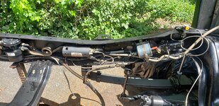

the fuel delivery modal is bad. it's the part in the frame where the 4 lines come in, 2 lines go out, then it goes to high pressure pump.
here is a picture of the system when I was building my F 350
It is the round can looking thing to the left. You will find it is not rebuildable, and is filled full of dirt.
It also hates ethanol. It also hates sitting. I have since upgraded to 94 fuel system, 2 intank pumps, new wiring harness, 92 f 350 ecm. Tired of paying $300 a year for fdm's

Because the fdm is shutting off the fuel flow. the high pressure pump can't supply fuel the the rail if it can't pull it thrpugh the modual.
Ok, so let's explain what this thing is.
there are no check valves in this fuel system.
so when you switch from rear to front the fdm switches where the fuel returns, and front to rear, where it returns.
when it decides to crap out and shut down it goes in the middle and will not allow fuel to flow in either direction.
Basically the hpressure pump is just sucking nothing and giving nothing to the rail.
Ford realized this flaw and redesigned the system in 90. then again in 93.
This is what the fdm looks like inside. Like I said before You can't fix it, and I can guarentee it is your issue.
Just for S& giggles, take the supply line from the lift pumps on the back side of the FDM, let them hang over a bucket.
Hit the key. see if fuel comes out of both lines when switching tanks from your lift pumps when cycling the key.
My bet is yes.
hook the lines up, cycle the keys again with the lines off the other side of the fdm, my bet there will be no fuel either tank.
