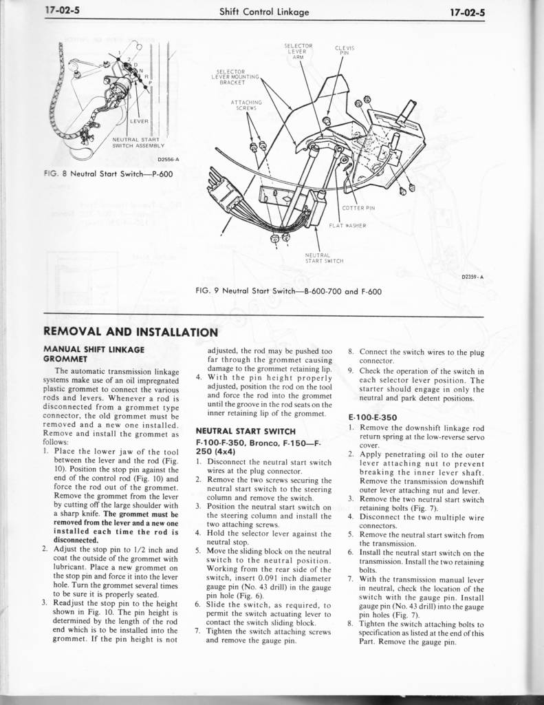

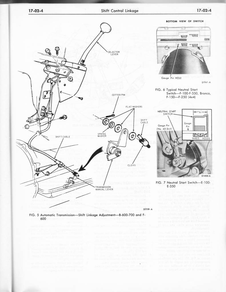

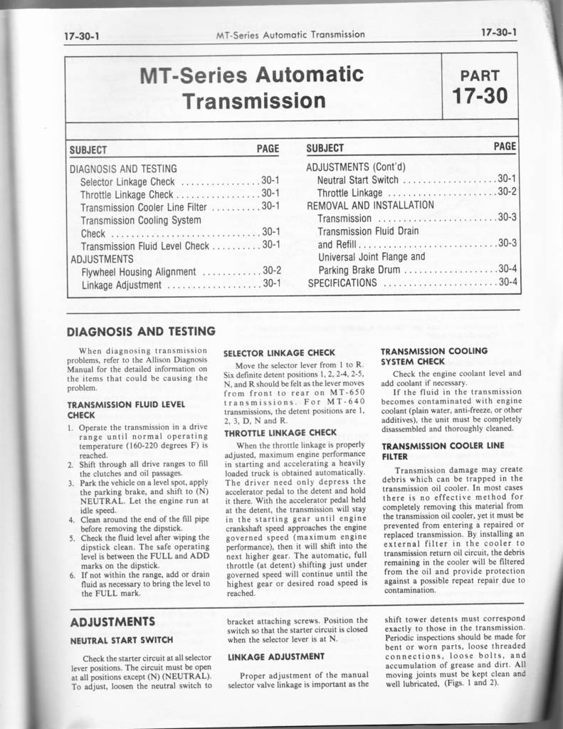

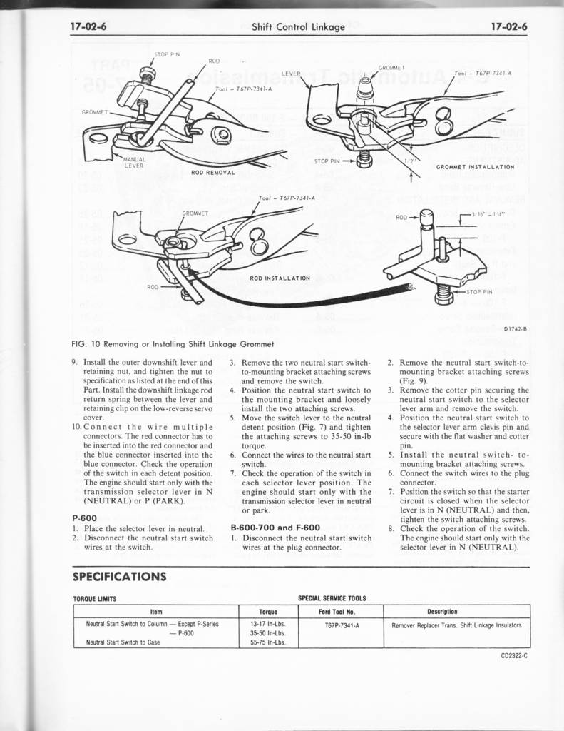

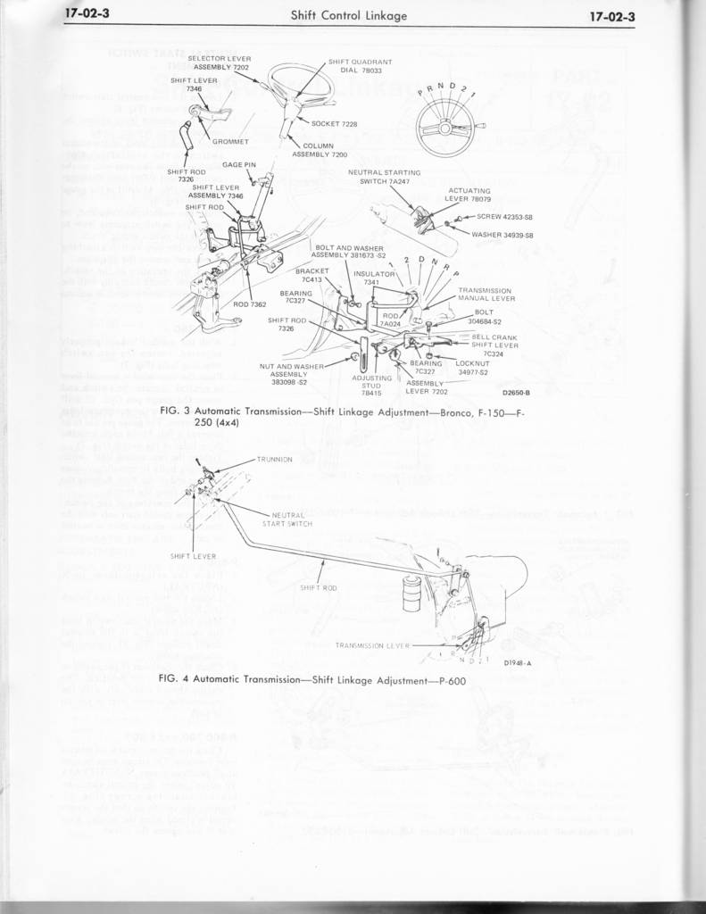

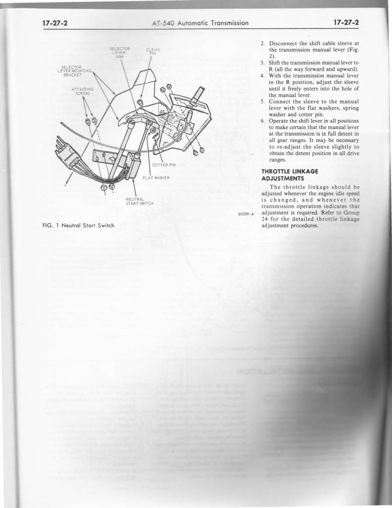

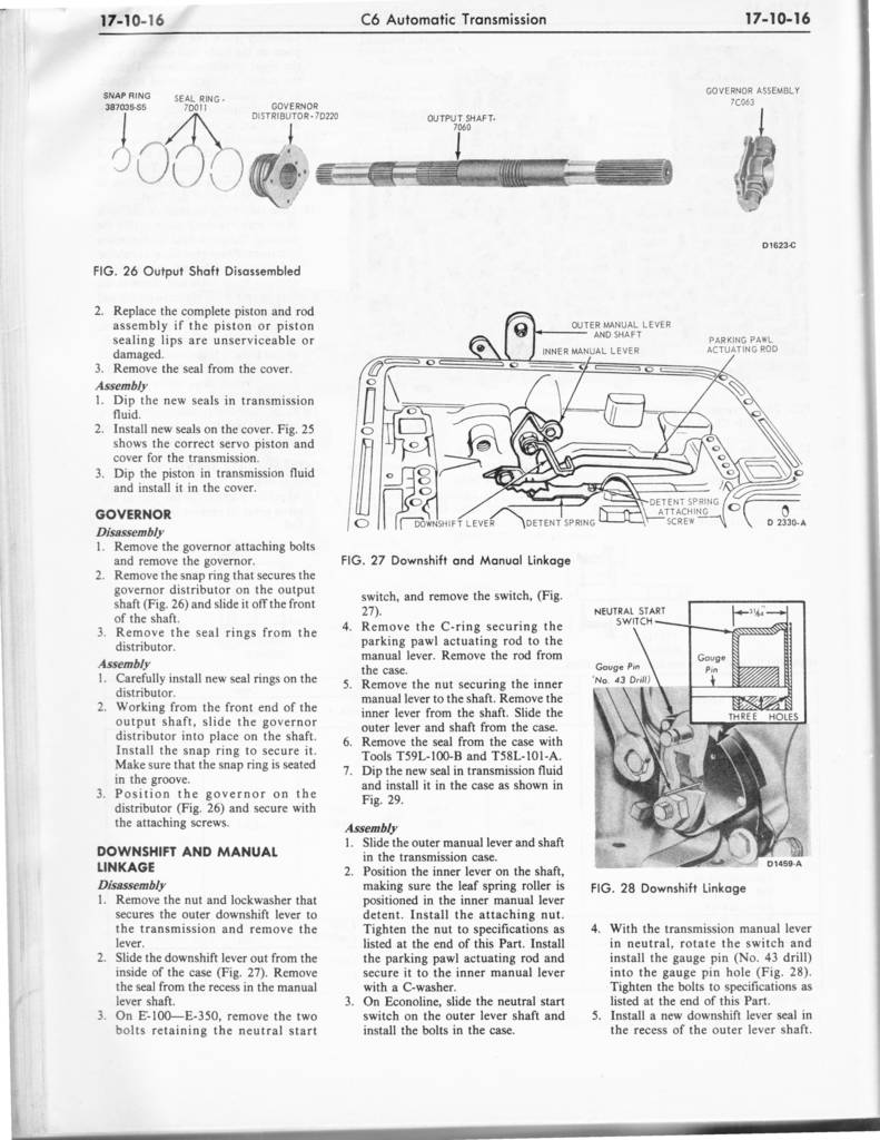

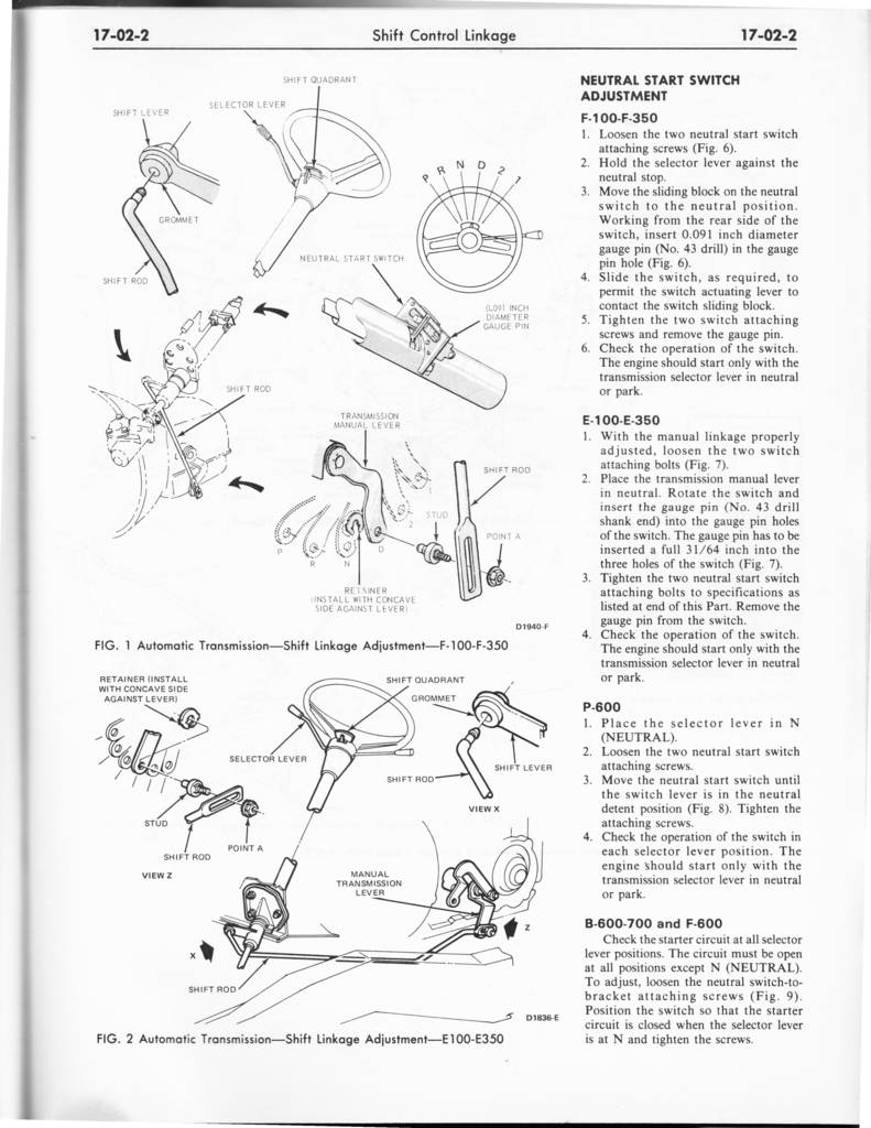

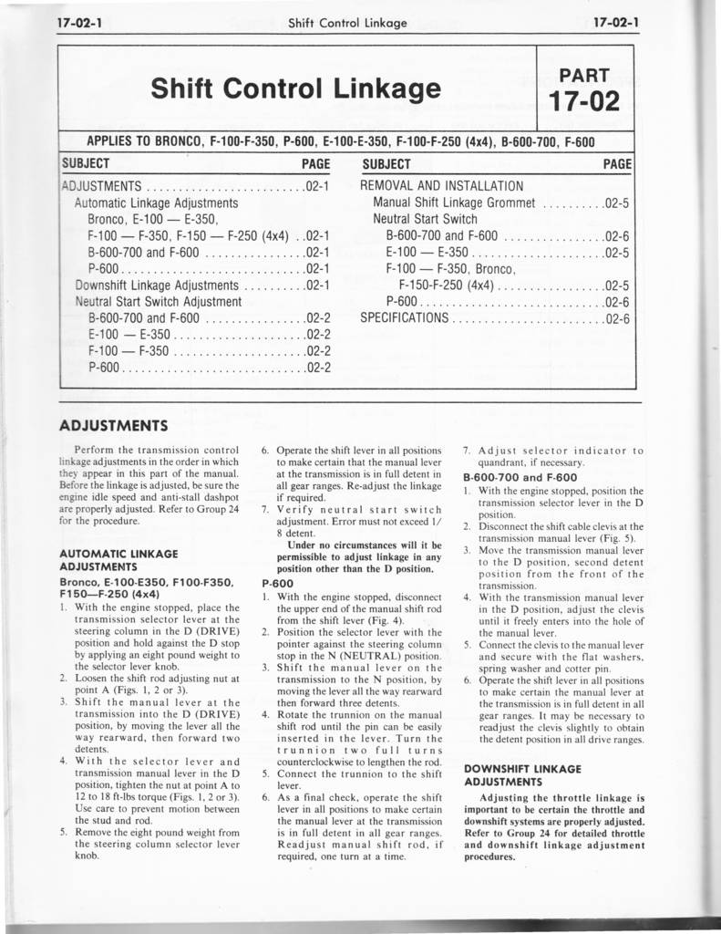

After looking through this section, I noticed that the information for the neutral start switch(neutral safety switch) is incorrect. It still lists the switch as being mounted on the steering column, which is not the case. The NSS(starting 1978) is located on the linkage on the side of the transmission.
