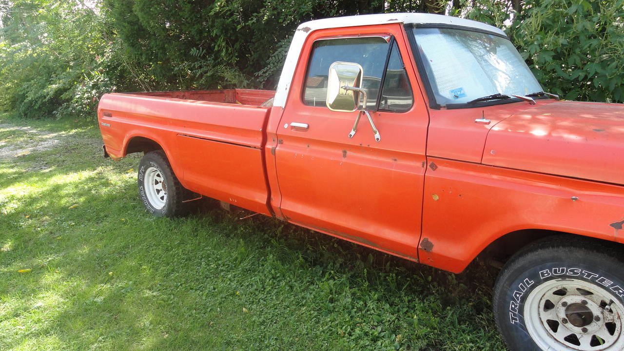

Hi, I'm new to this forum and new to this gen of ford. My question is, I just recently bought a 73 f100 ranger xlt long bed 2wd and I was wondering if it was the camper special. I was wondering if there were surefire ways to tell.if its in the Vin wat do I need to look for? It has the 460 married to a c6 tranny. Any replies appreciated. Pic below.

This is it.
Does this help?
Nothing in the VIN will indicate a camper special package.
I also wonder if they even made a F100 with a camper package. I thought they were only outfitted on F-250/350.
Neither will any codes stamped on the Warranty Plate.
F100/250 Camper Specials were introduced in 1965, F350 Camper Specials were introduced in 1967.
Depending on who you believe, F100 Camper Specials were either cancelled at the end of the 1967 model run or at the end of the 1972 model run.
Fordification claims 1967, but the Ford truck parts catalog lists F100 Camper Special parts thru 1972.

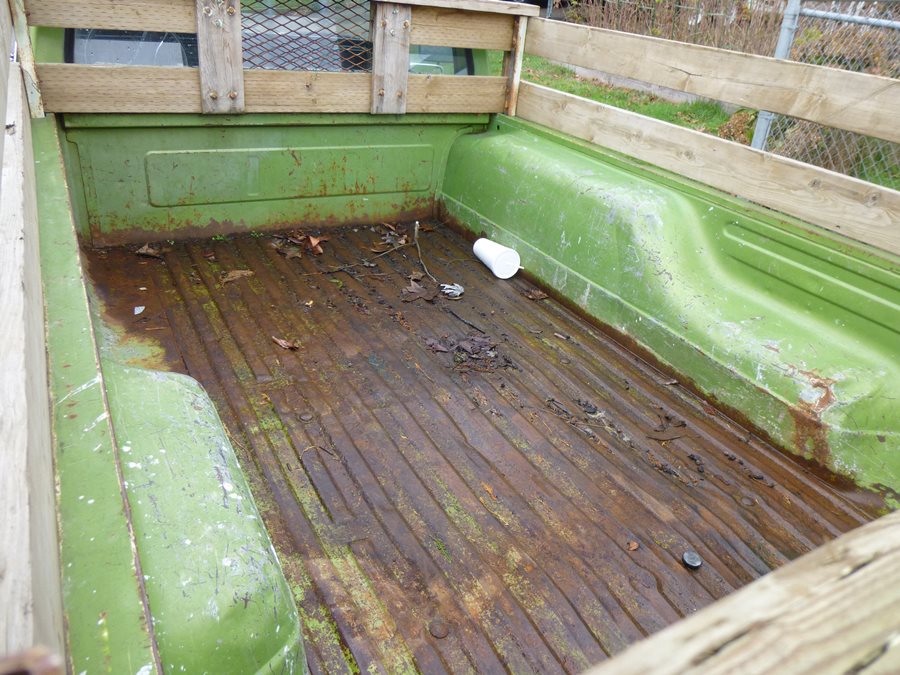

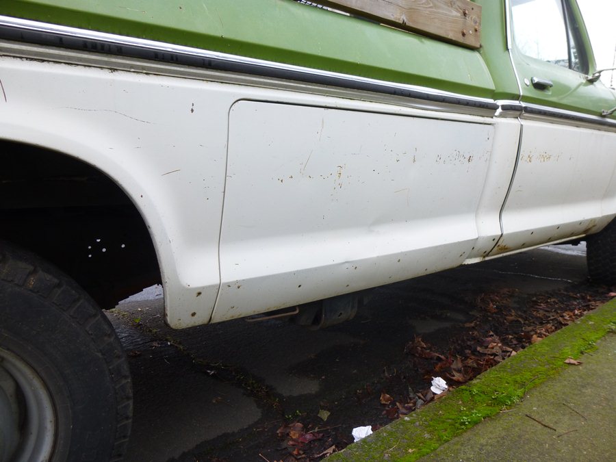

Well, I guess I have an odd-ball then. A 1973 f-100 with the extended wheel-base and spare-tire carrier in the bed side. Nothing has been modified or adapted that I can tell. Must have been a special order or something.
Well mine is definitely a spare tire carrier on the pass. side just in front of the rear tire. The wheelbase is also 140 inches(as opposed to 133 on a regular 8 foot bed).
No, I'm going by the rear spring pack, which is three; and 5 bolt wheels. Even the vin says f-100. Sure wish I knew how to upload pictures on here!
The bed has been swapped.
No F100/150/250 came from the factory on the 140" wheelbase.
F350's on the 140" wheelbase: 1973/76 Super Camper Special / 1973/79 Regular Cab Trailer Special / 1977/79 F350 Regular Cab Camper Special.
Ford dropped "Super" after 1976.
The Styleside bed is unique with the 140" wheelbase, as the rear axle is set back further.
