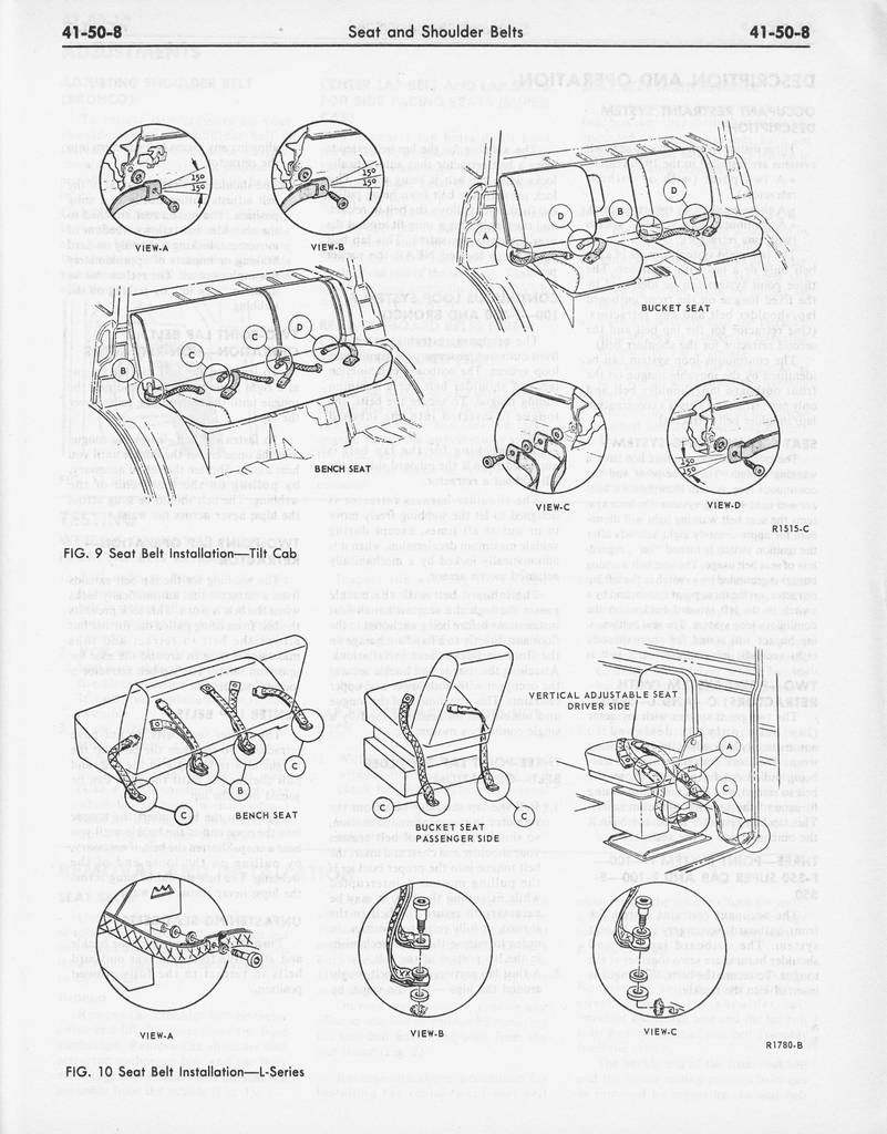

Hey!
Does anybody have a picture or diagram showing the orientation of the seat belt buckles, and how they are bolted down behind the seat? I've tried a few configurations that don't seem right. It's been too long!
76' F250 (Tank behind seat.)
Thanks,
Derek.

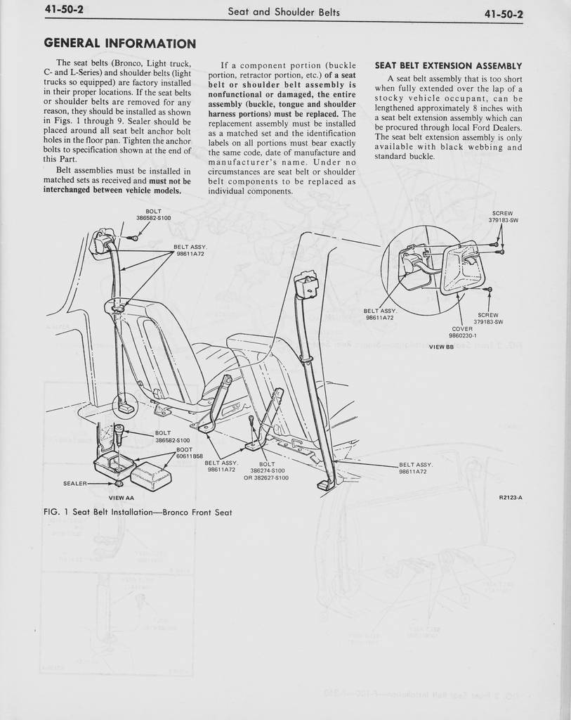

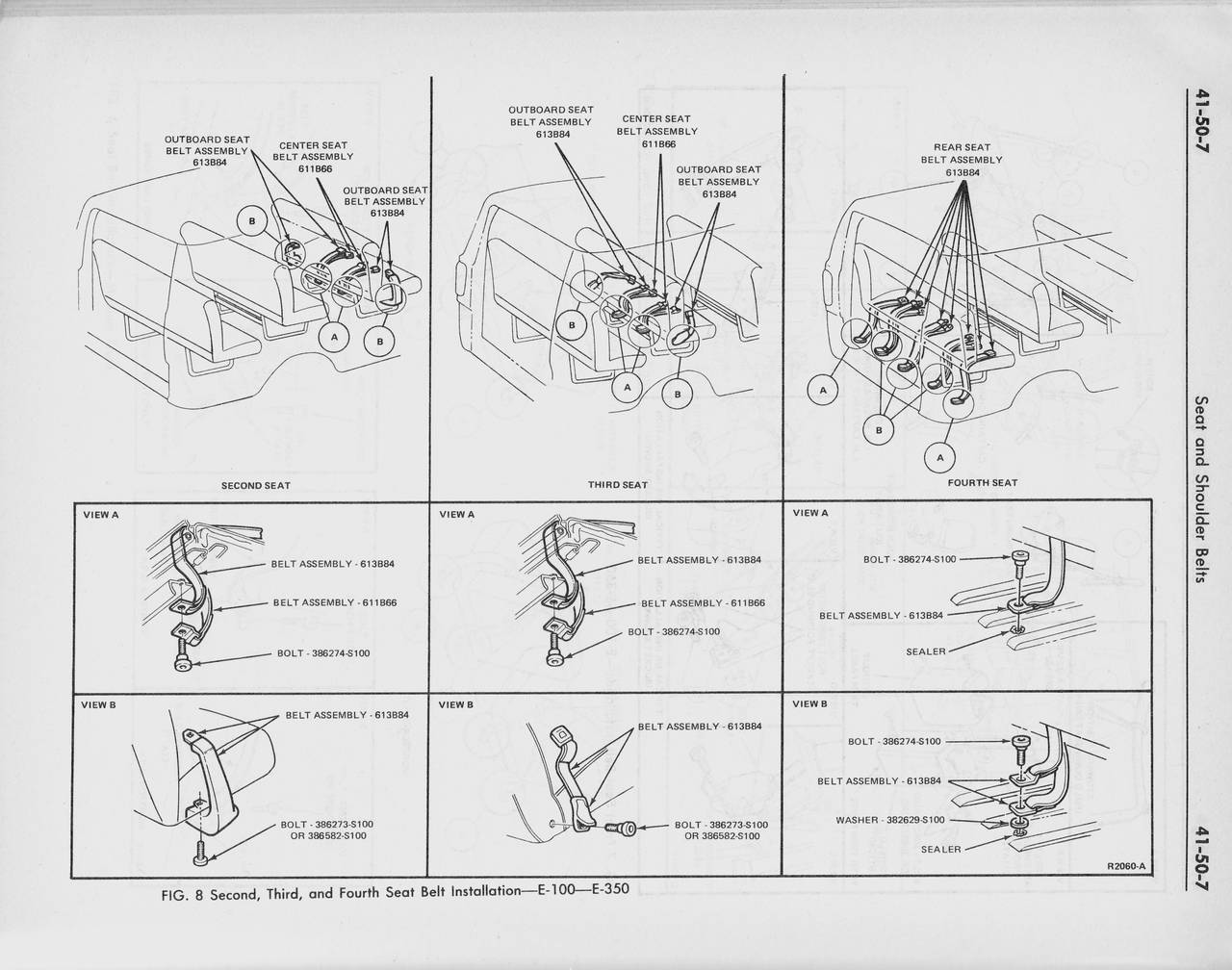

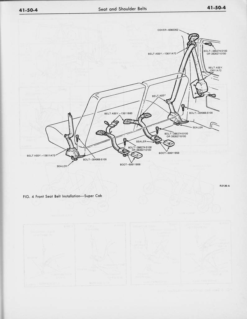

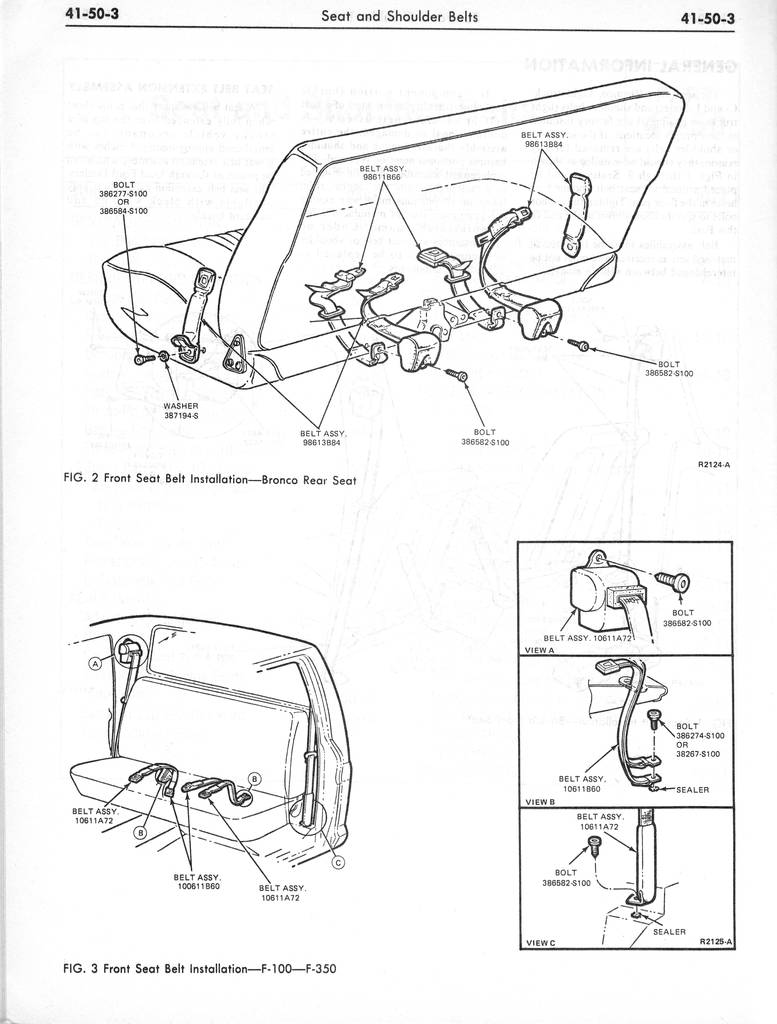

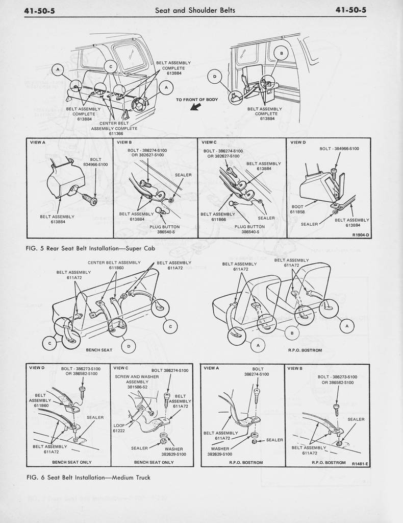

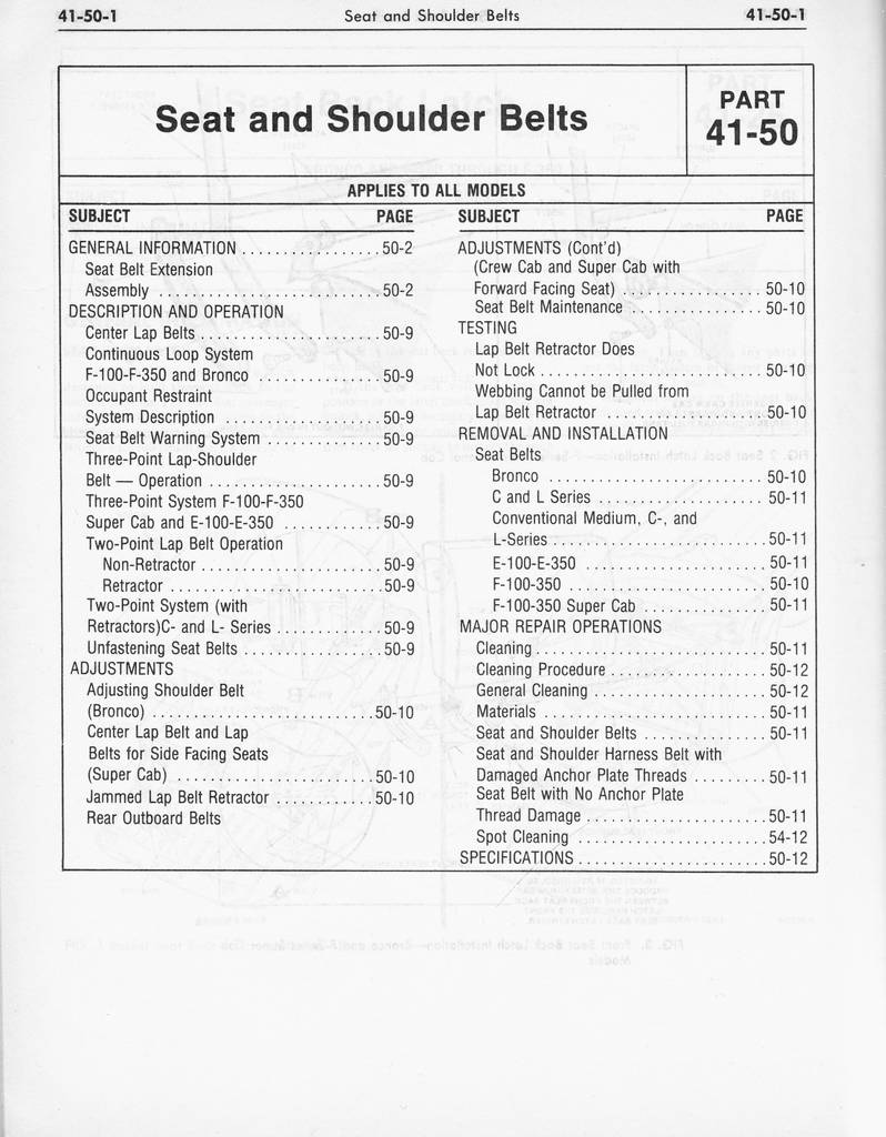

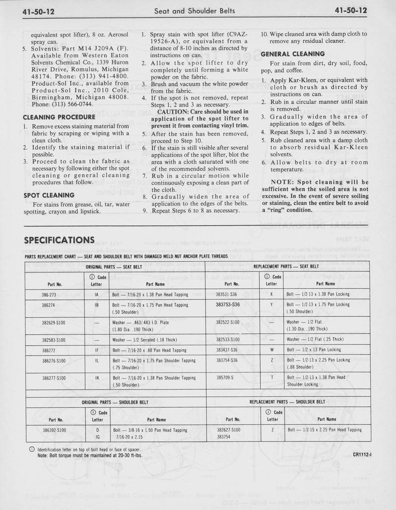

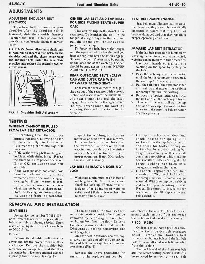

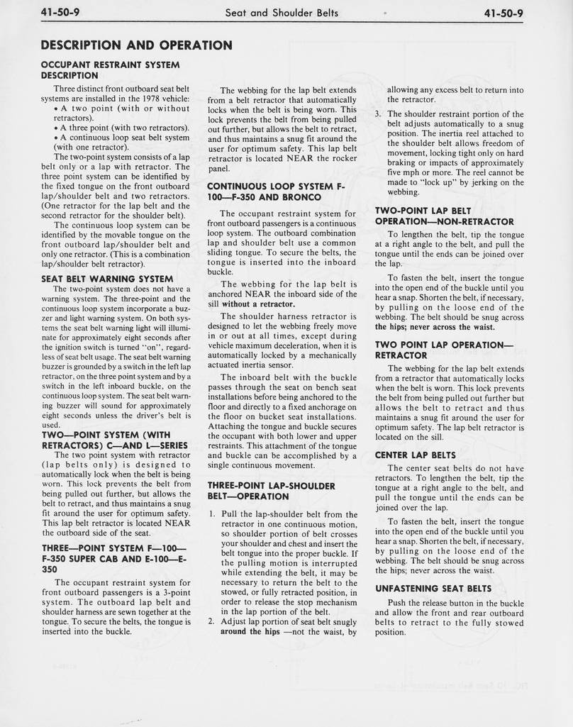

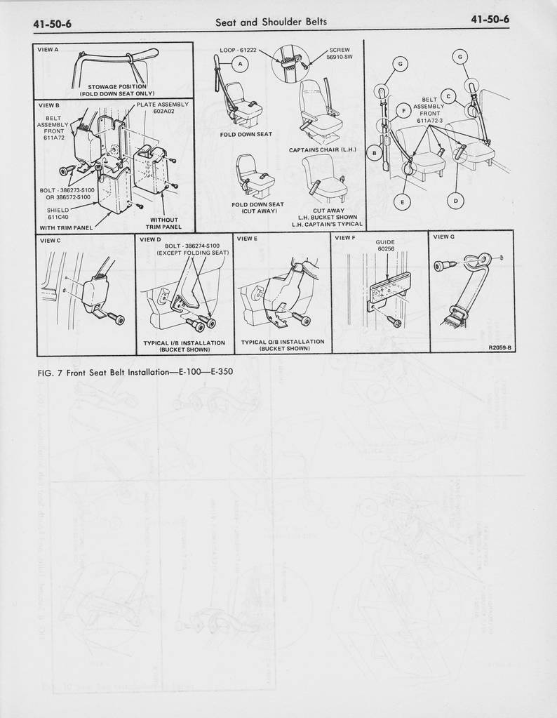

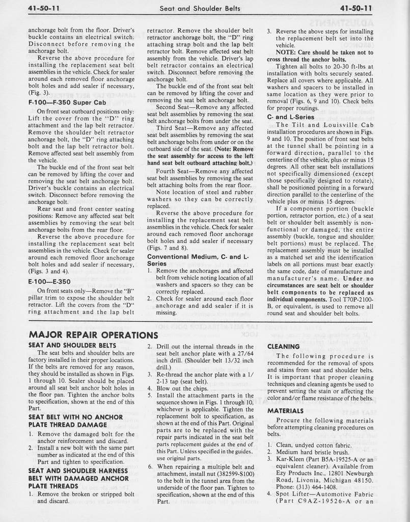

The entire section on seat belts from the 1978 ford manual is listed below. Hopefully it has what you need.
I'm guessing there would be no difference with the gas tank behind the seat, since the anchors sit so close to the rear of the seat?

Perfect!
Thanks a lot!
