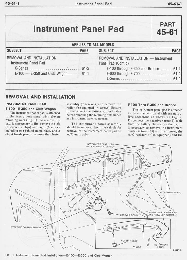

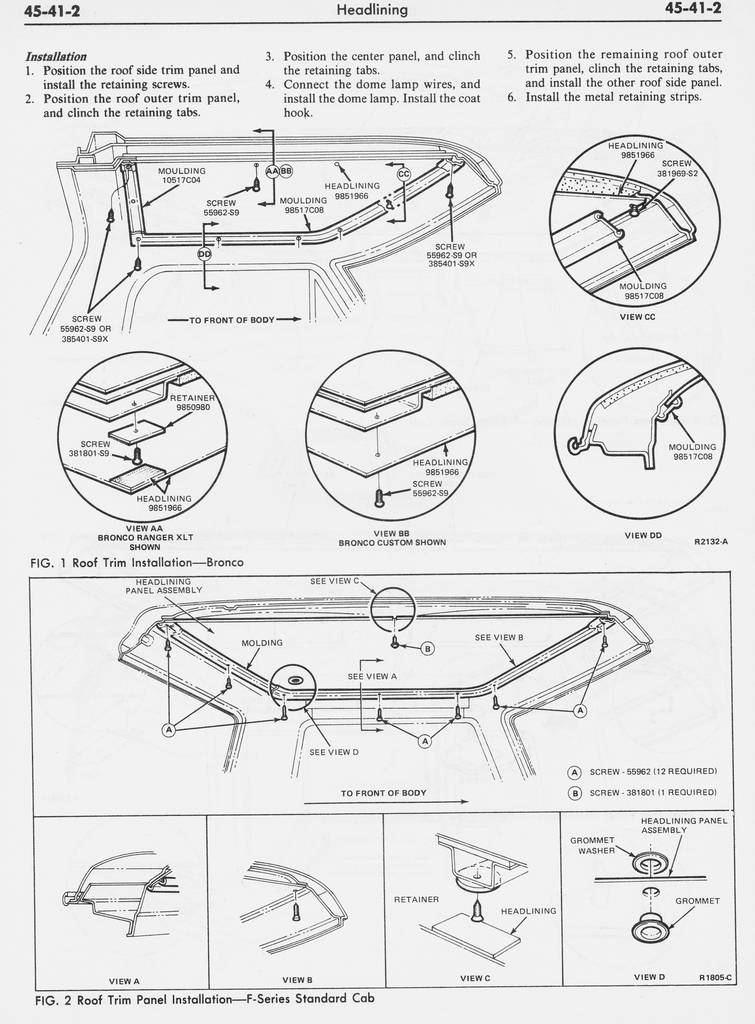

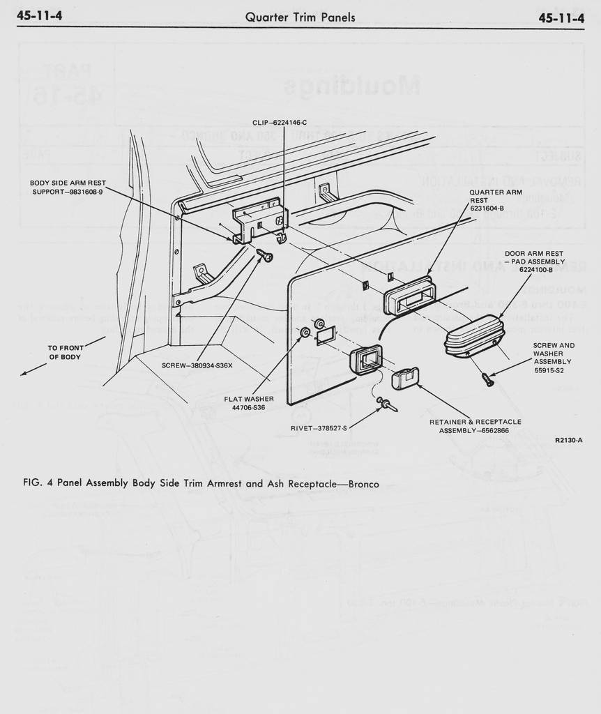

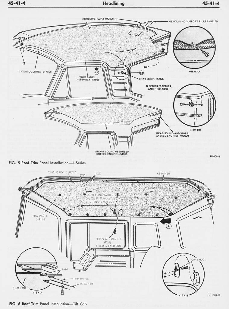

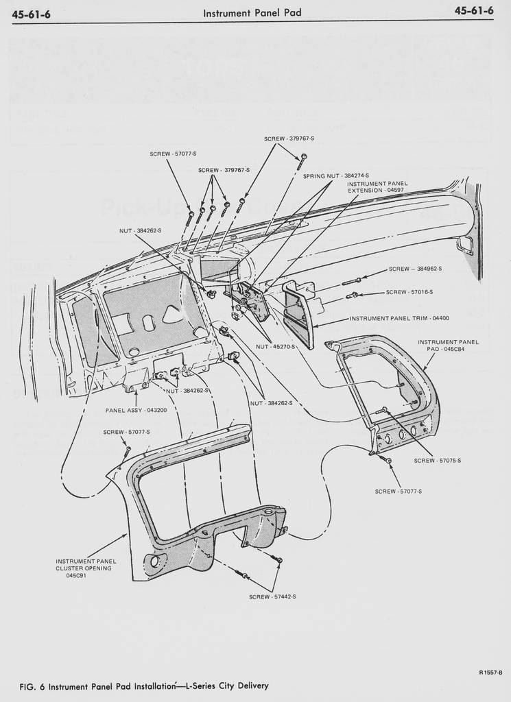

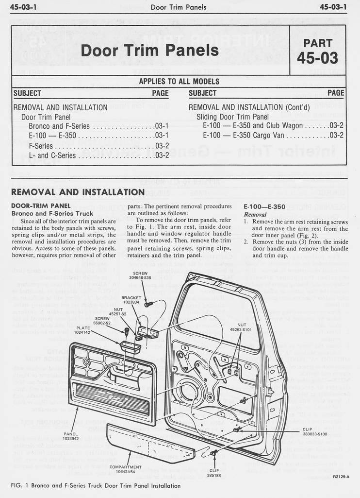

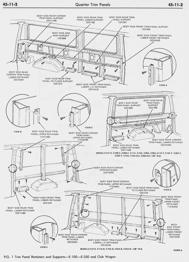

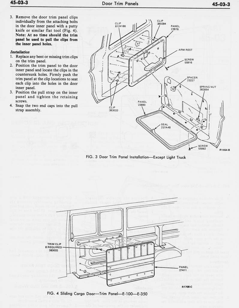

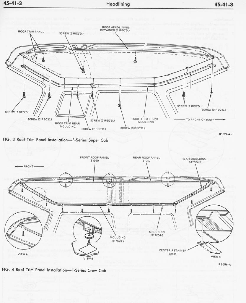

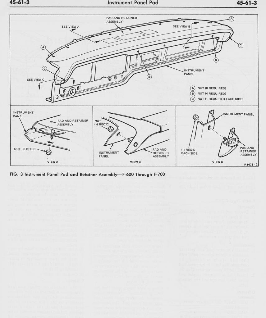

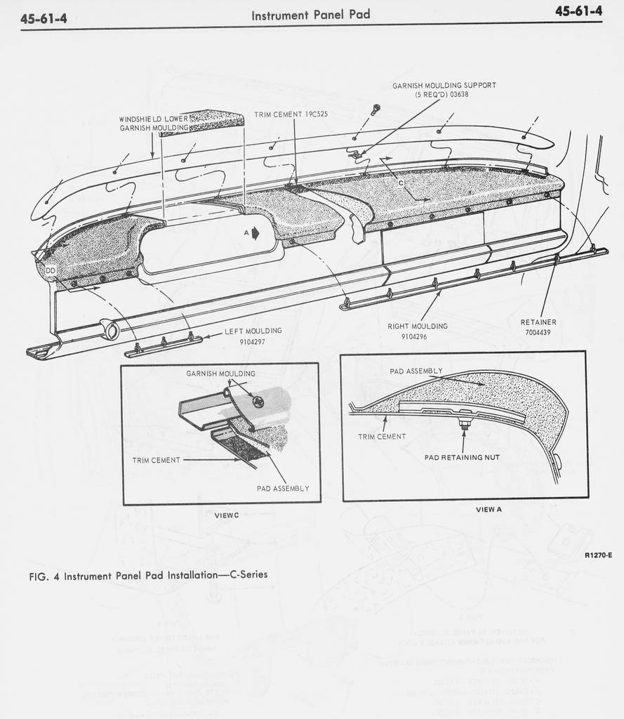

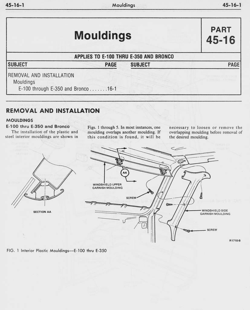

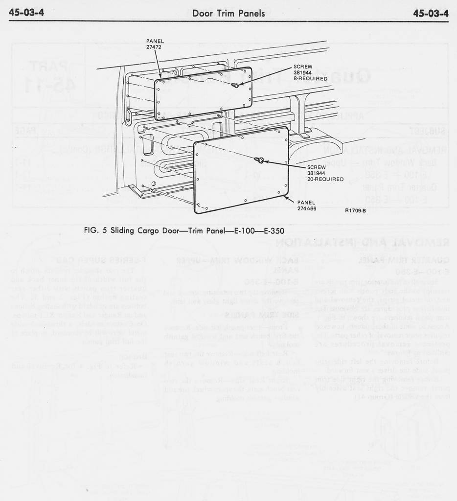

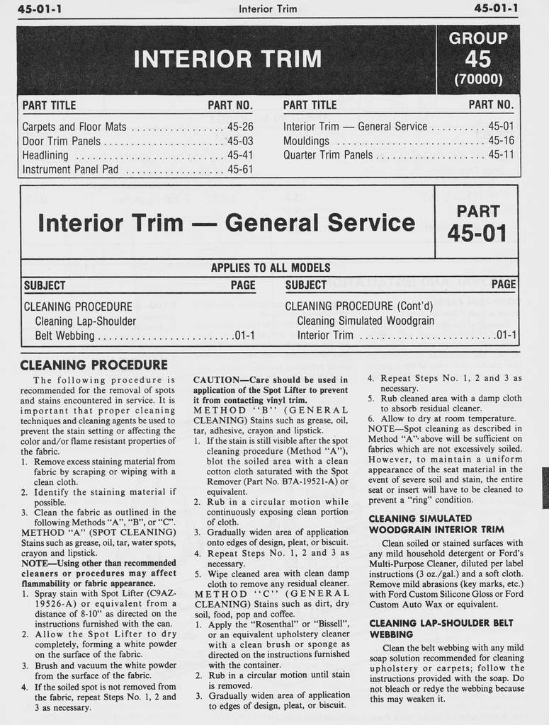

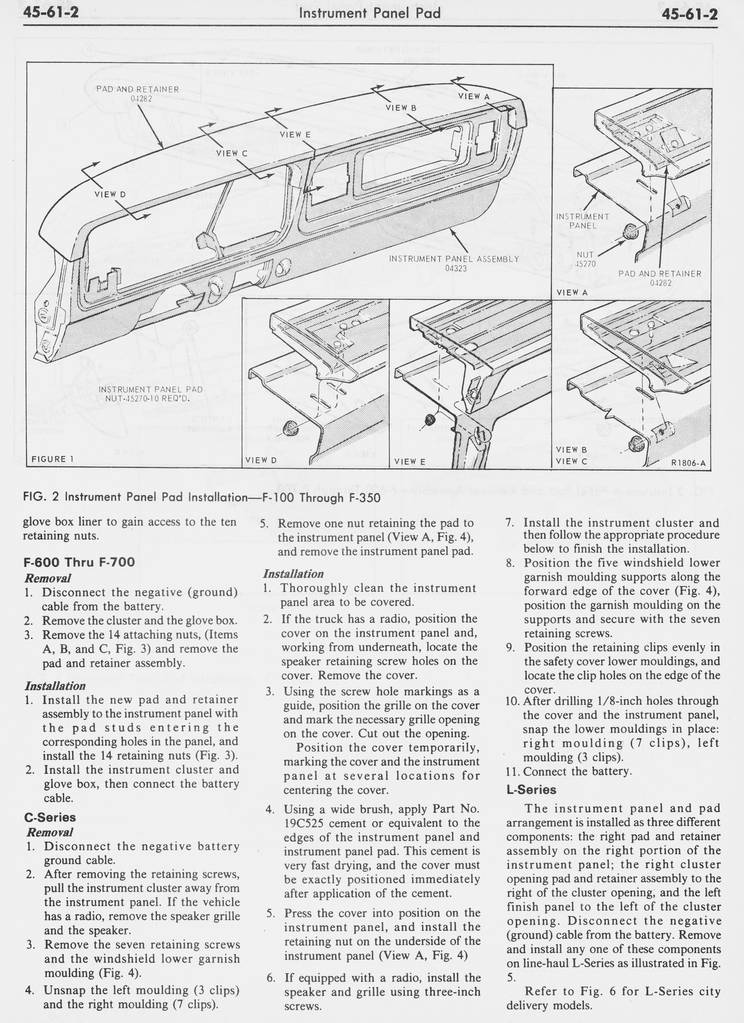

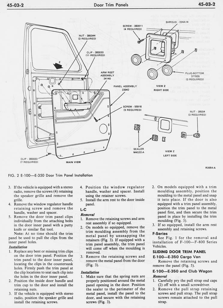

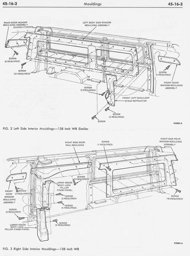

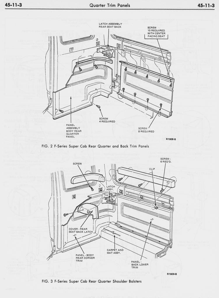

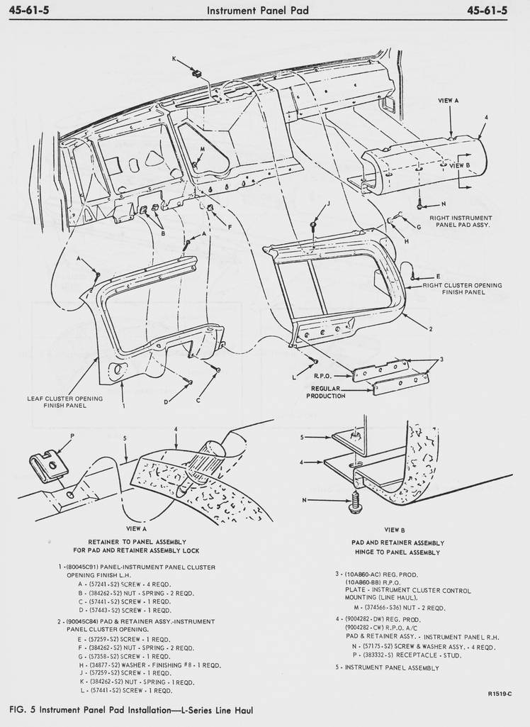

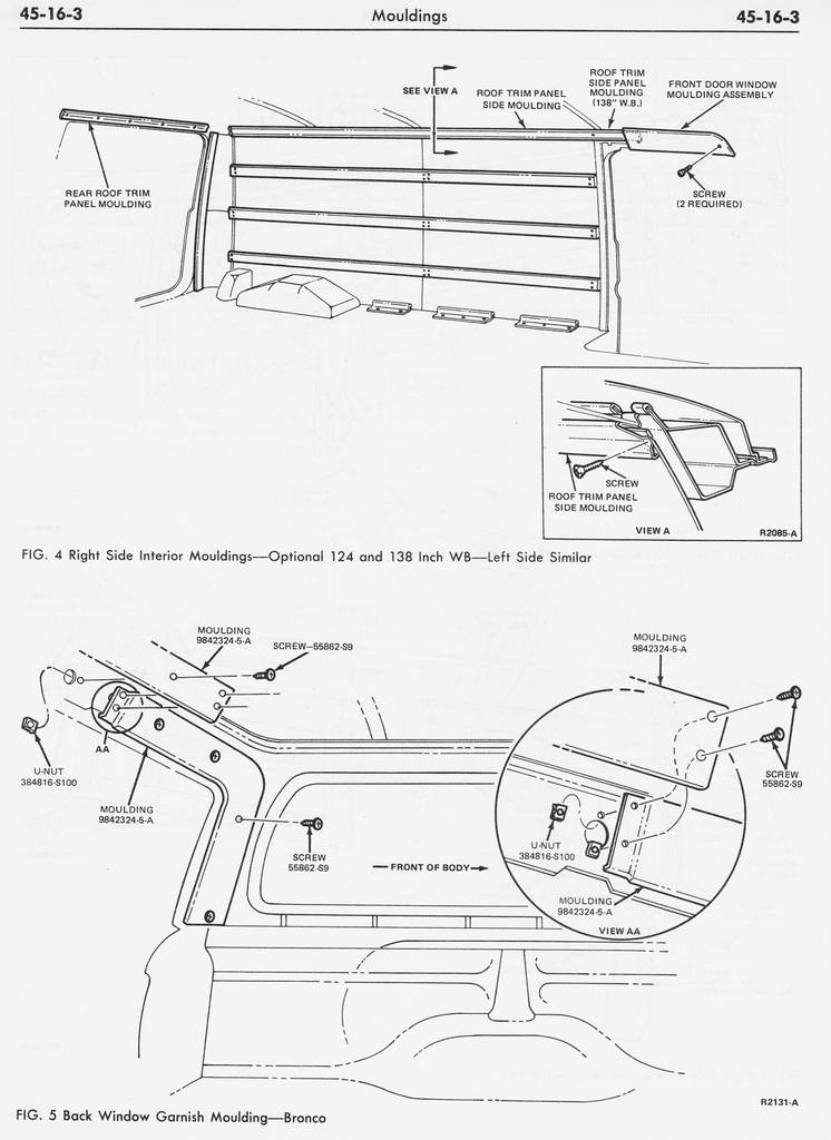

1978 Ford Shop Manual Vol 3&4 - Group 45 - Interior Trim

Group 45 Complete.
