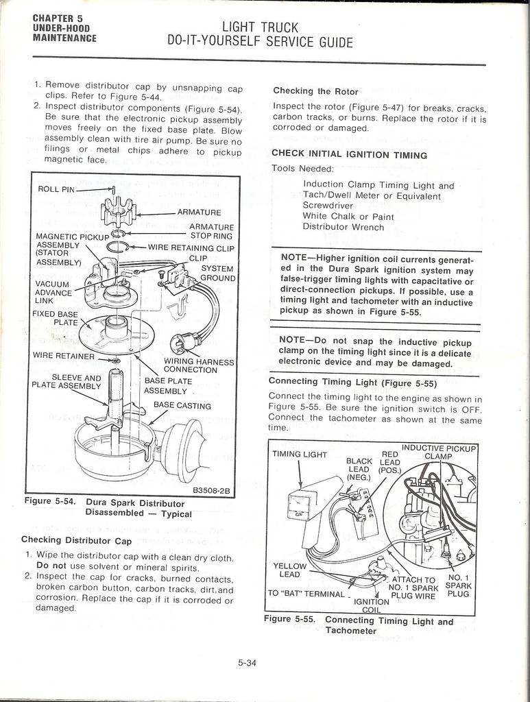

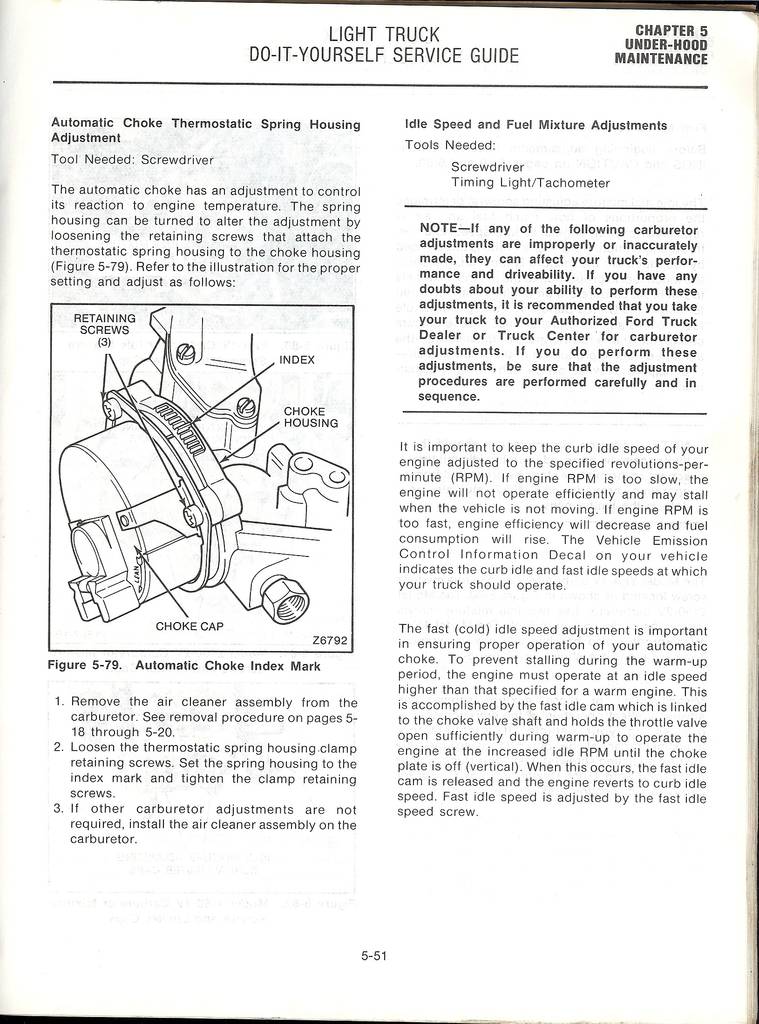

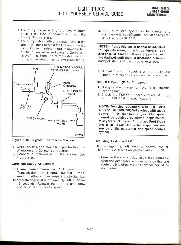

Jul 24, 2011 Moderator #1 DNFXDLIThe Token CanadianStaff member49,0831,089 The Great White North Chapters 1 through 5 (page 8) Last edited: Jul 24, 2011

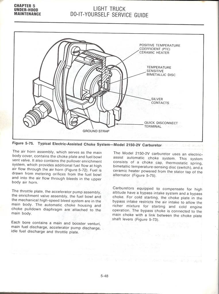

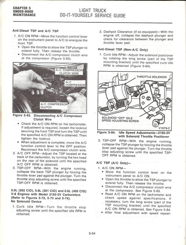

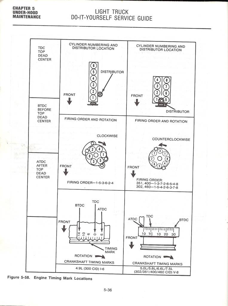

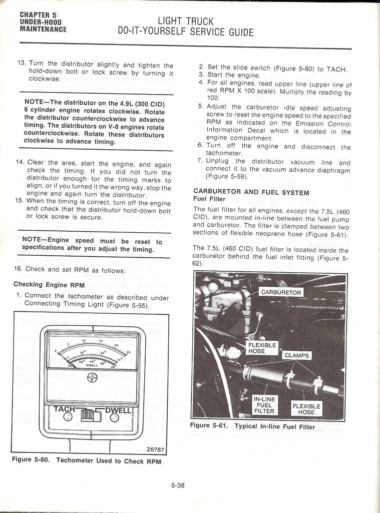

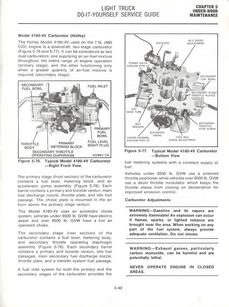

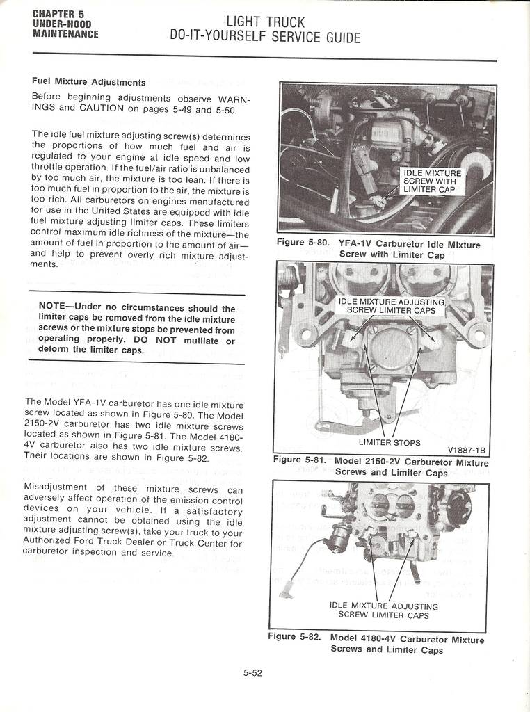

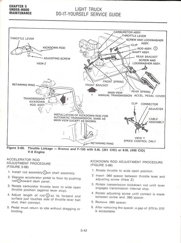

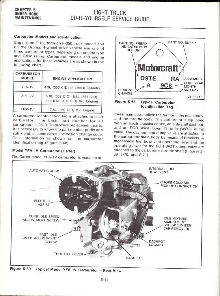

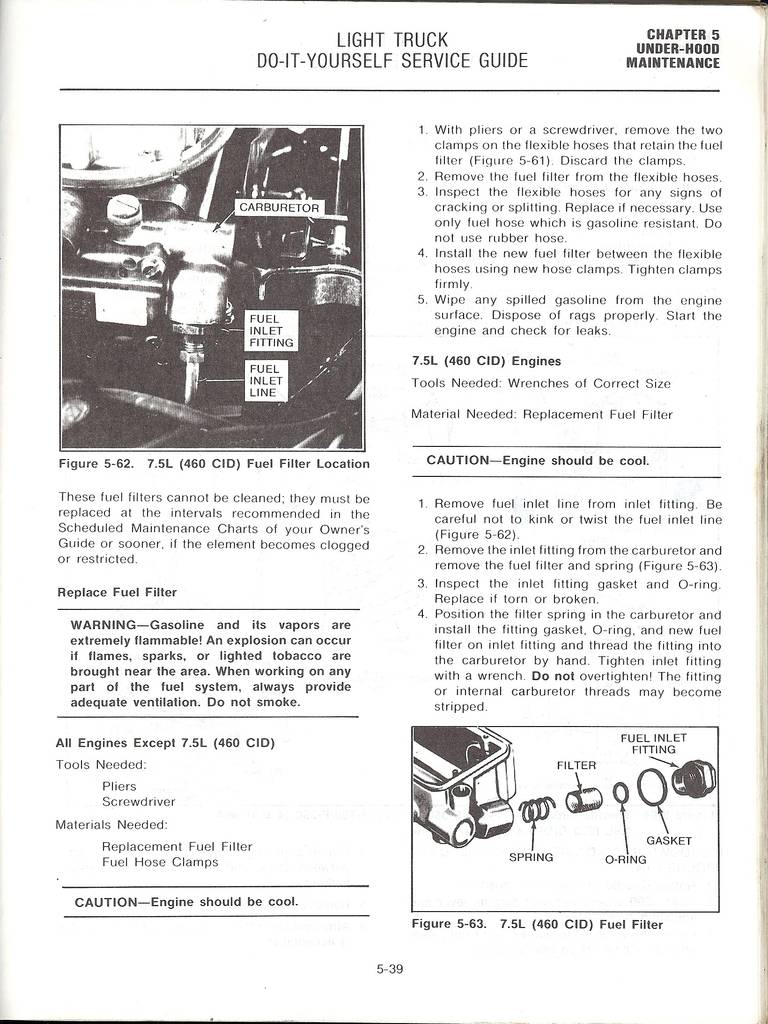

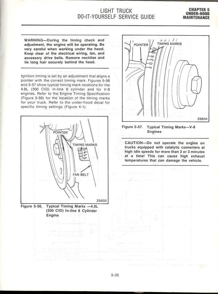

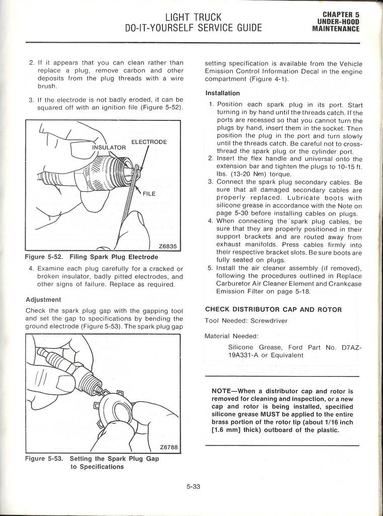

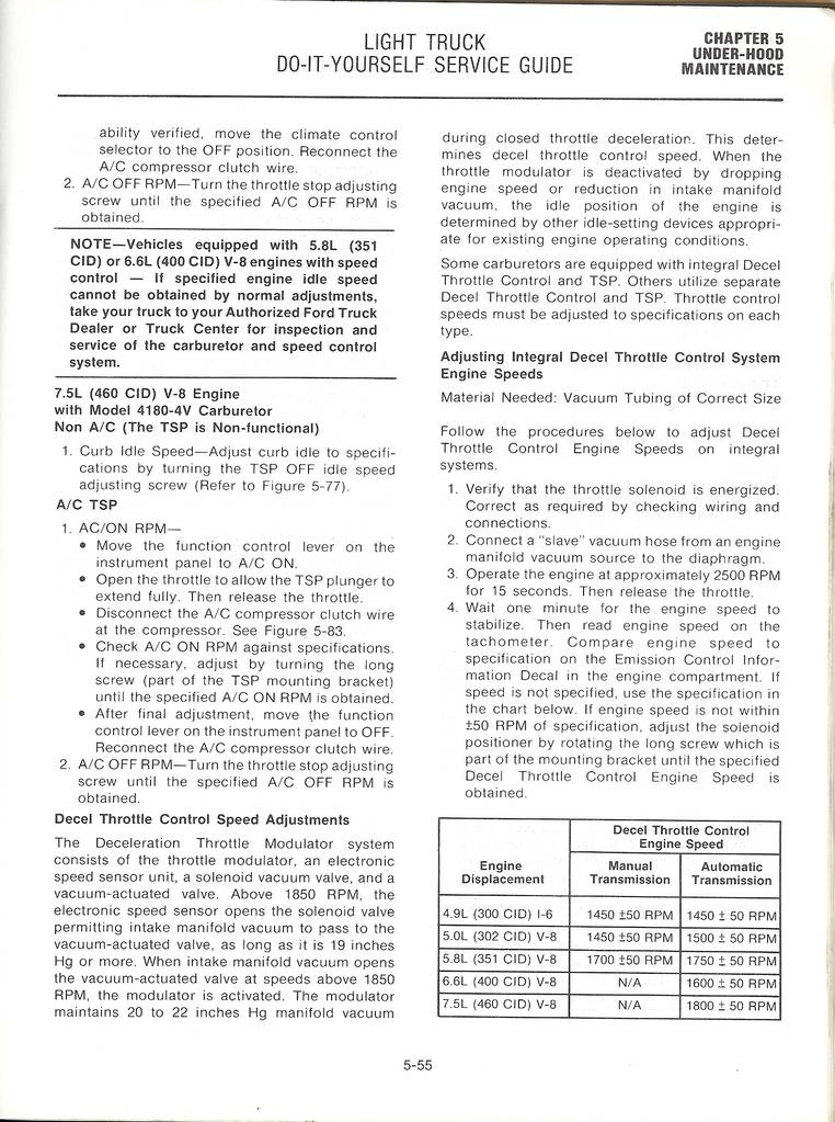

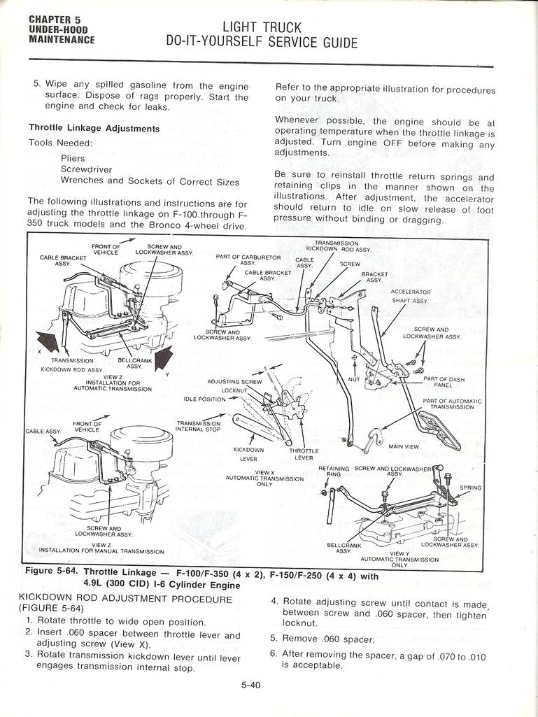

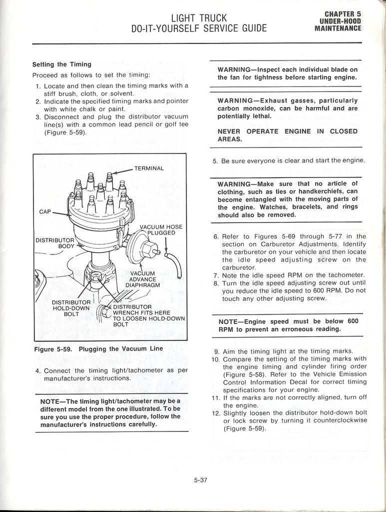

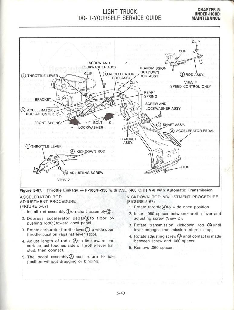

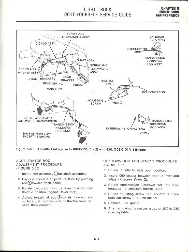

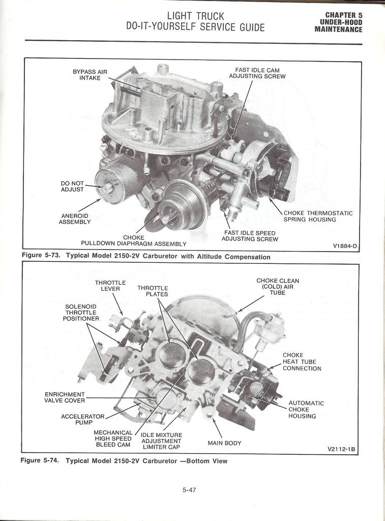

Jul 24, 2011 Moderator #2 DNFXDLIThe Token CanadianStaff member49,0831,089 The Great White North Chapter 5 pages 33-57 [ Last edited: Jul 24, 2011

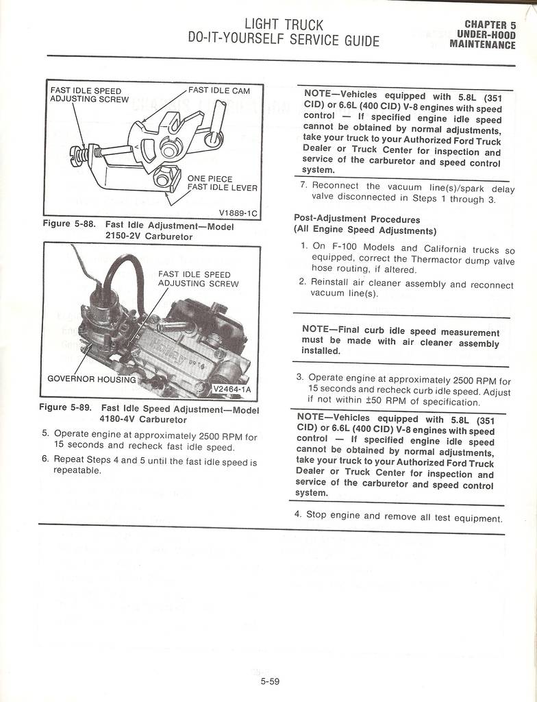

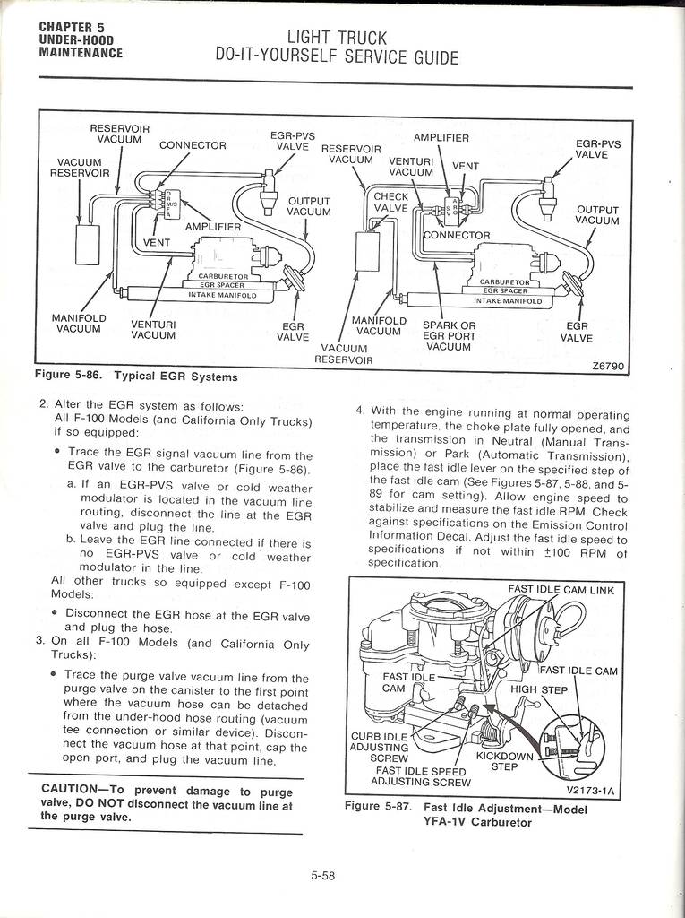

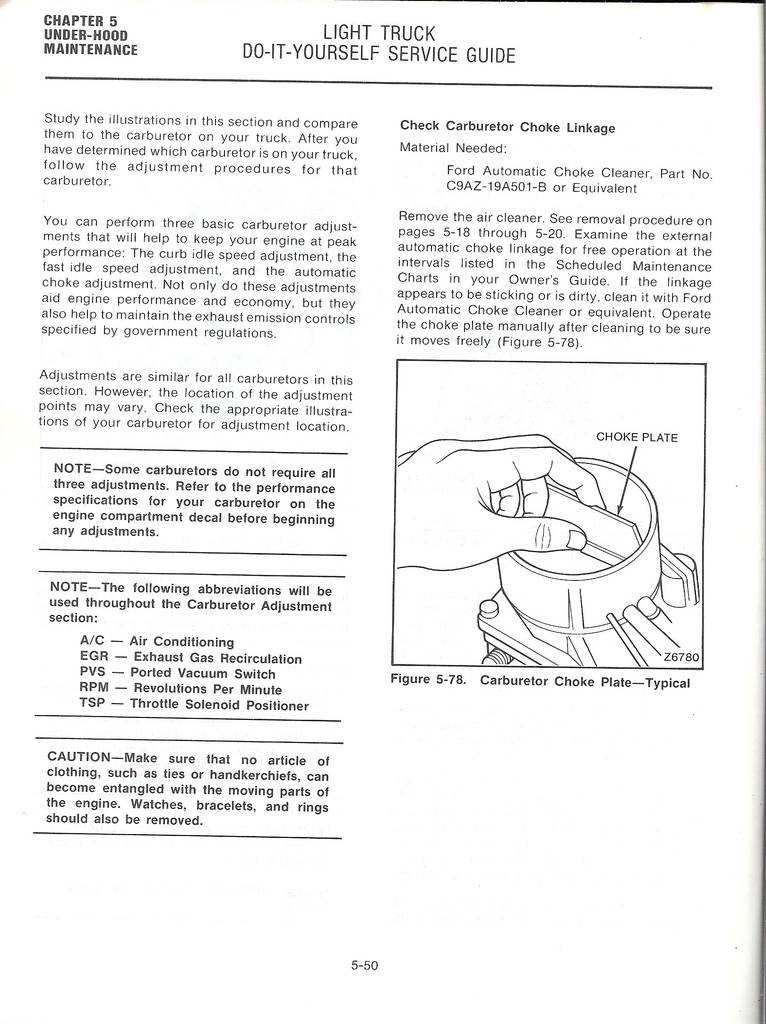

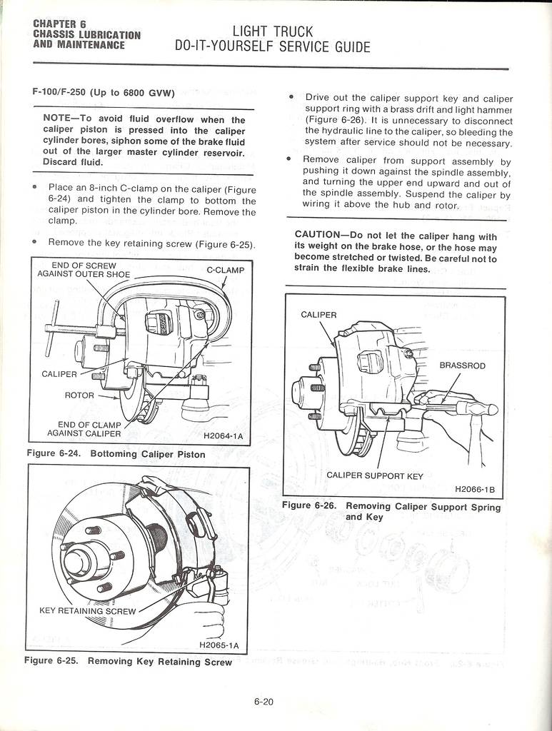

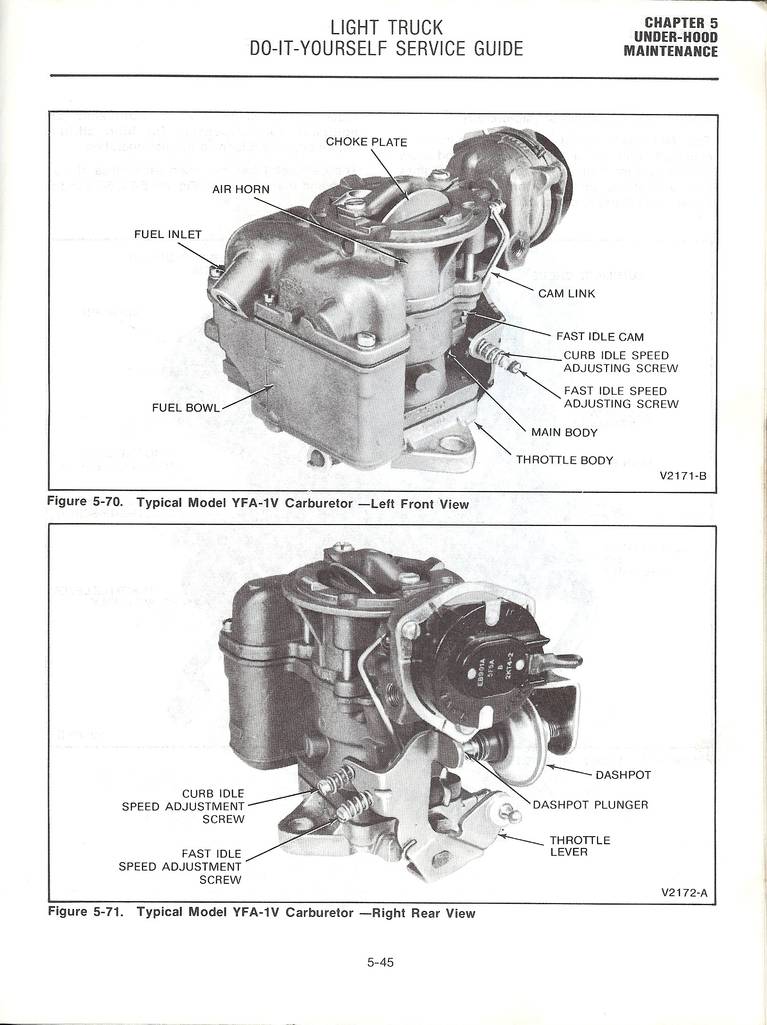

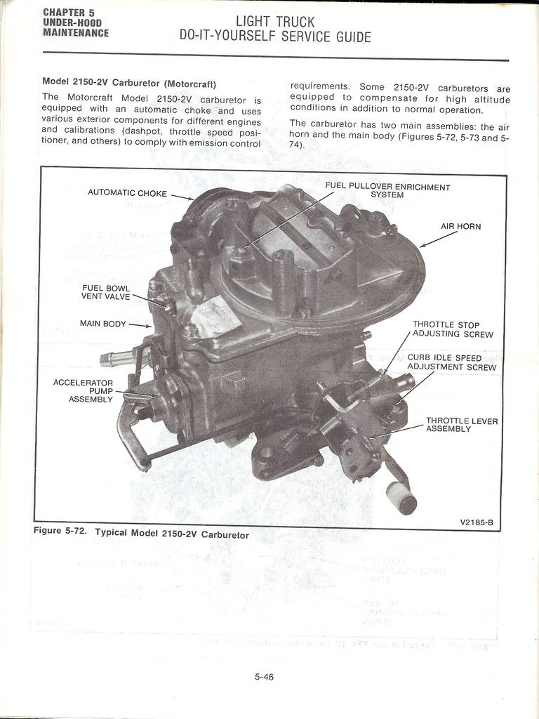

Jul 24, 2011 Moderator #3 DNFXDLIThe Token CanadianStaff member49,0831,089 The Great White North Chapter 5 (to end) Last edited: Jul 24, 2011

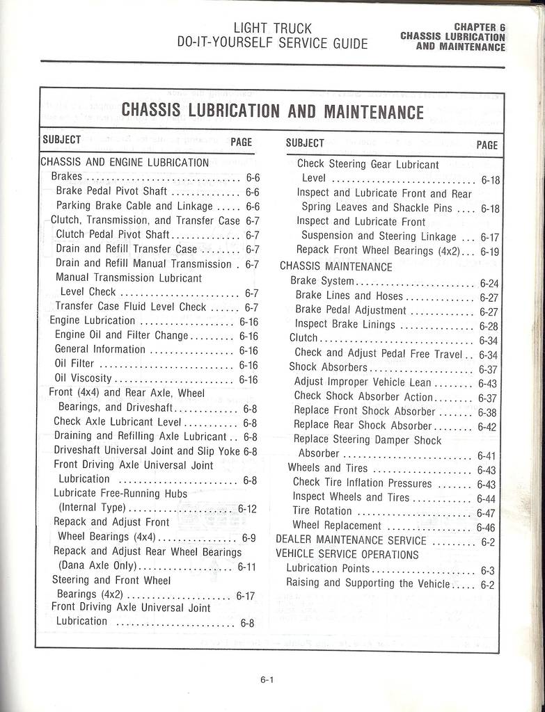

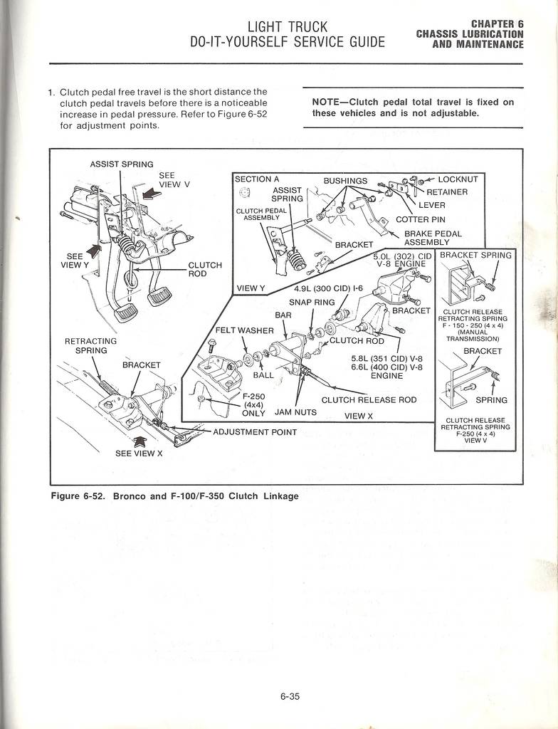

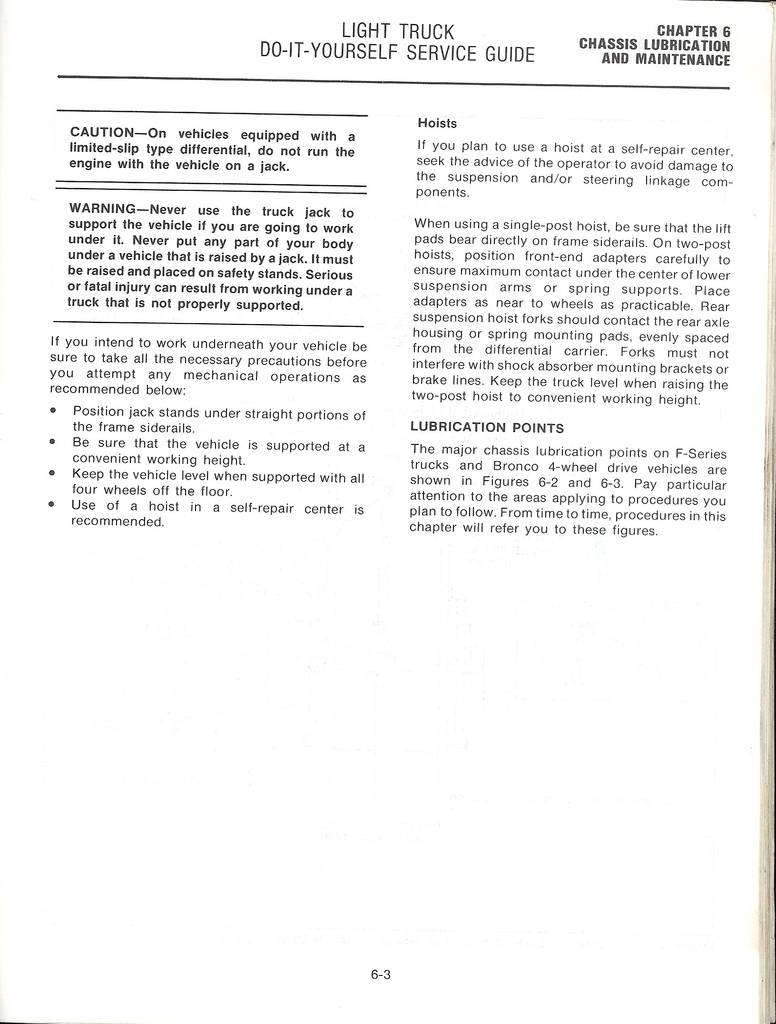

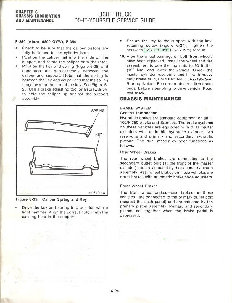

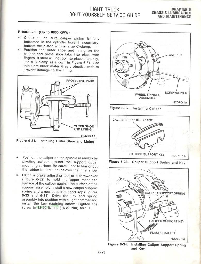

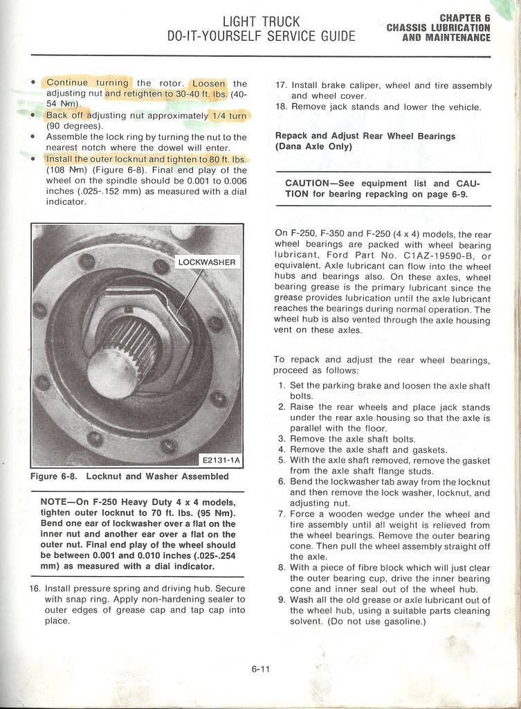

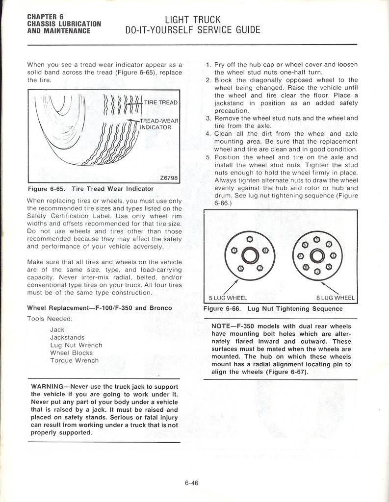

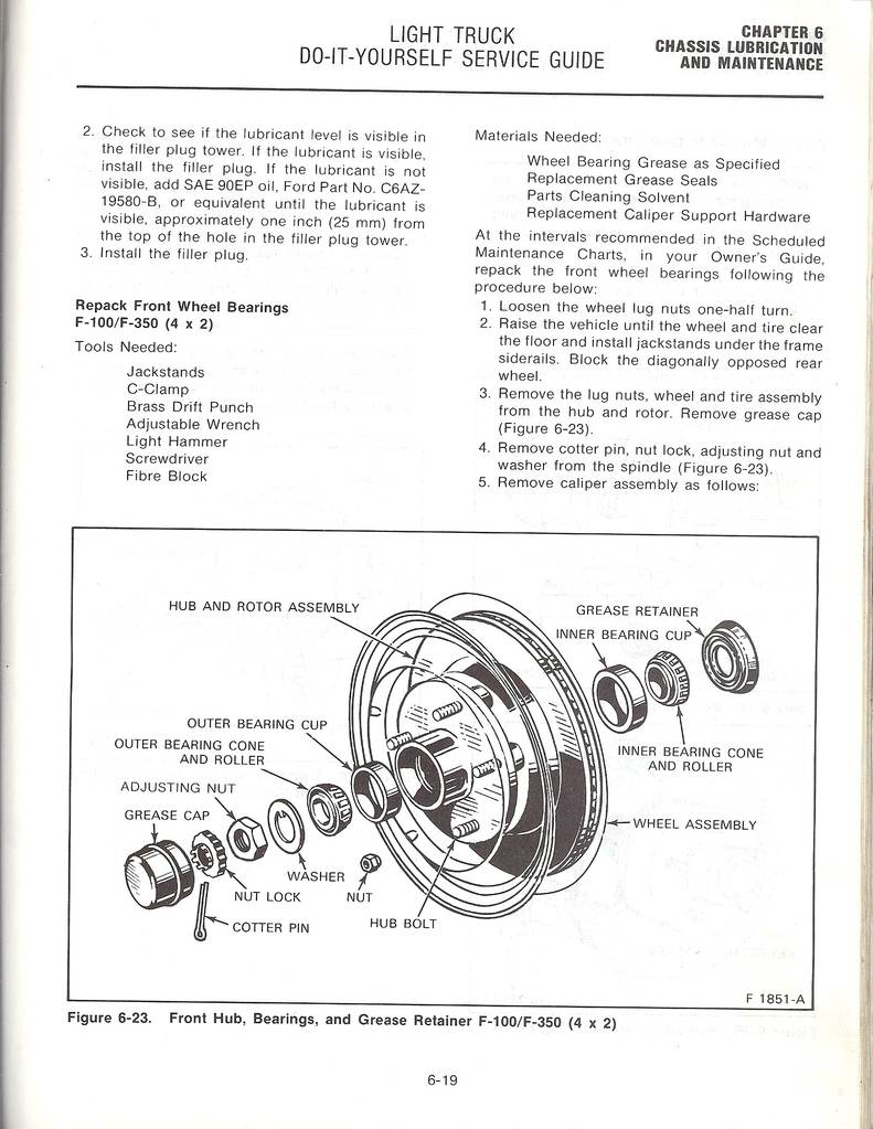

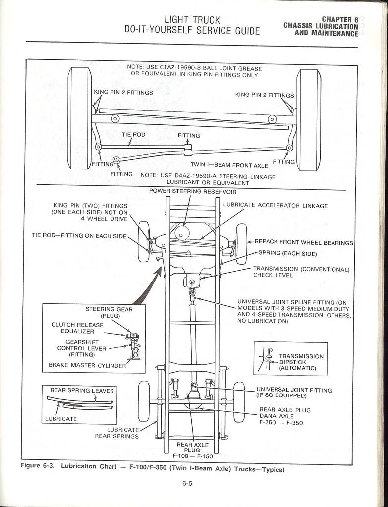

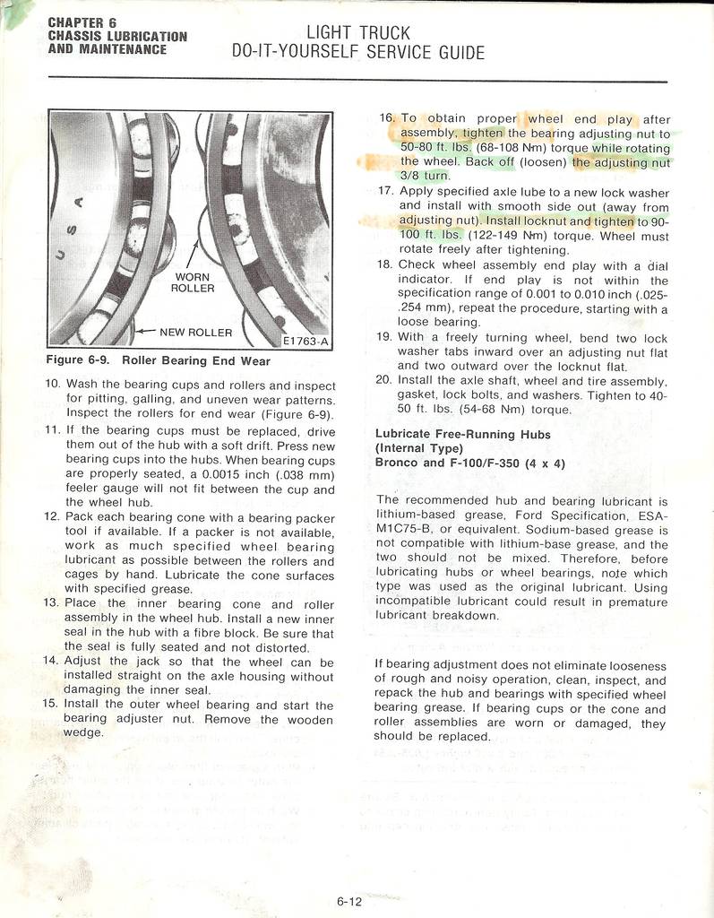

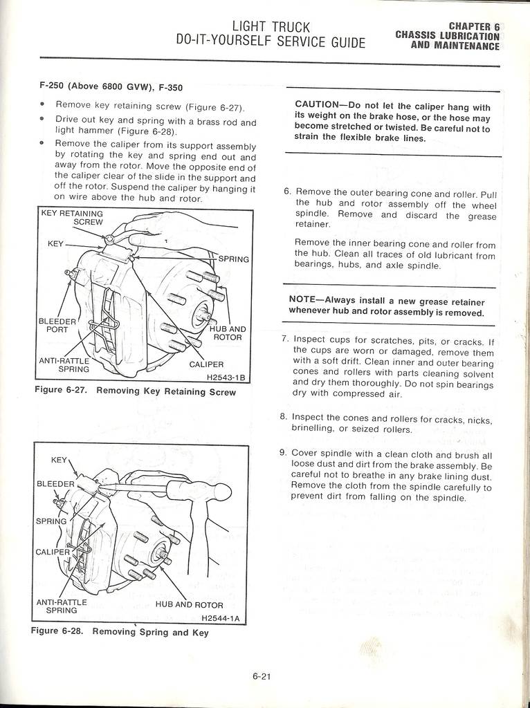

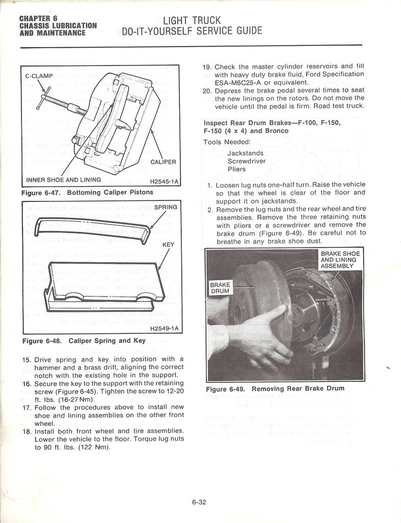

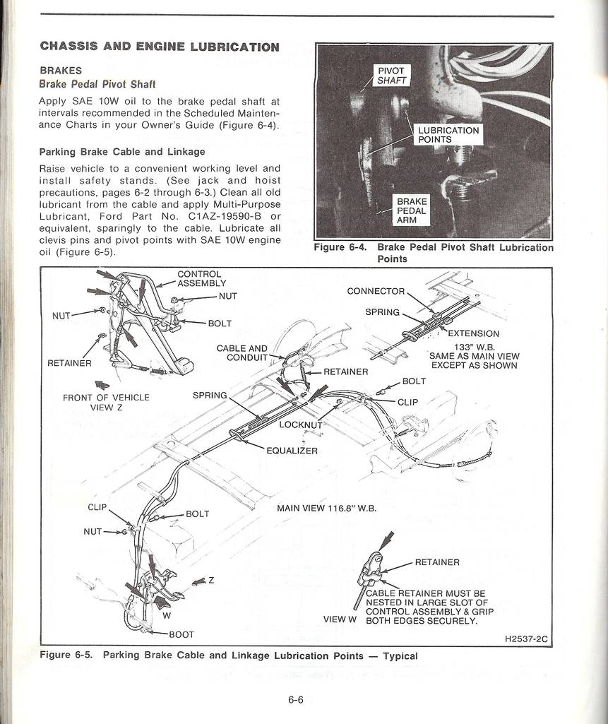

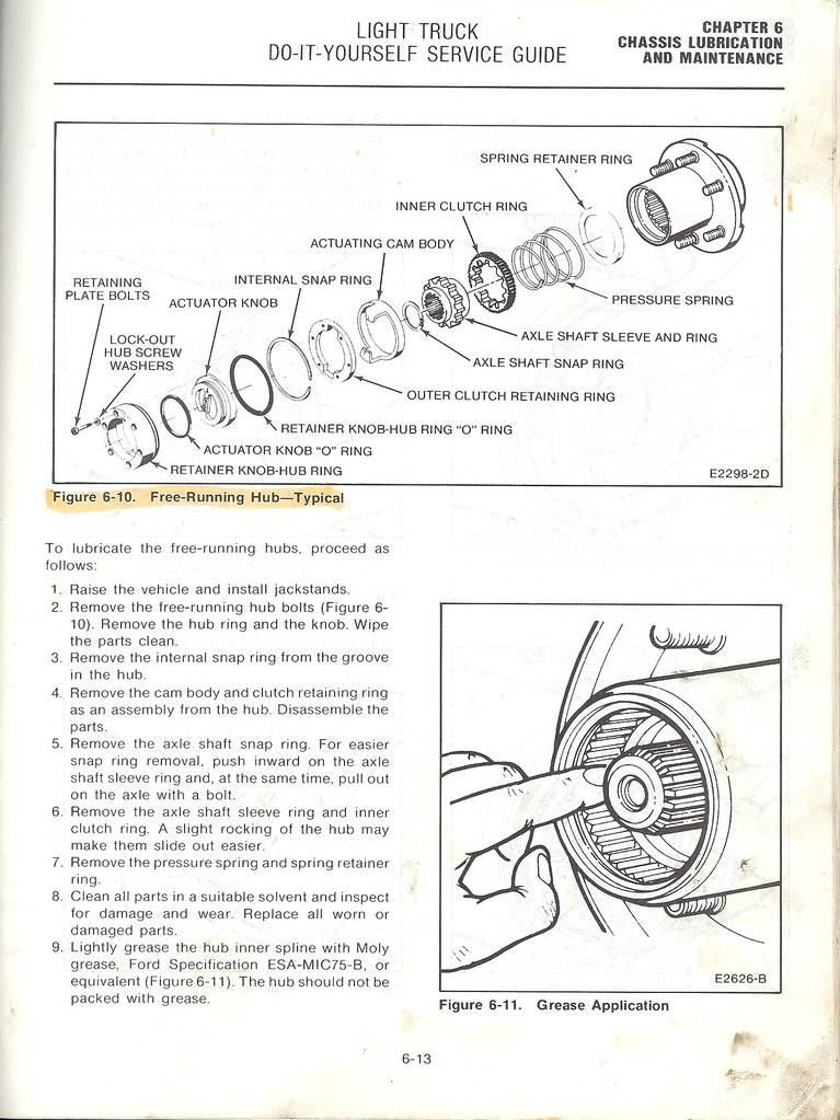

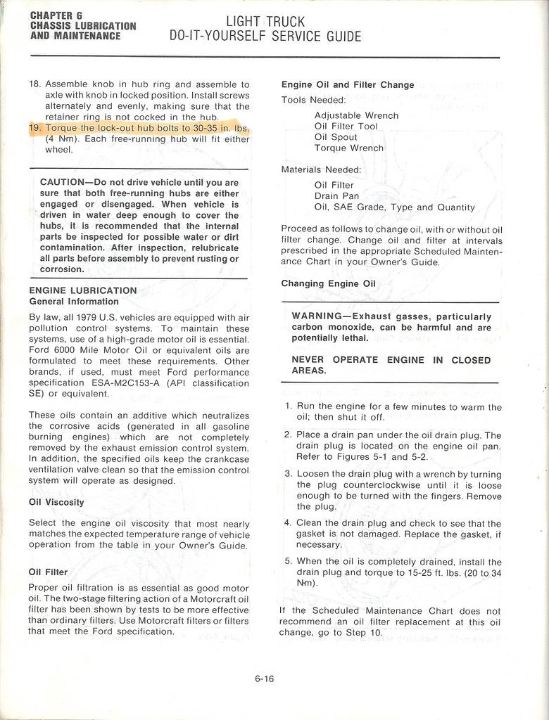

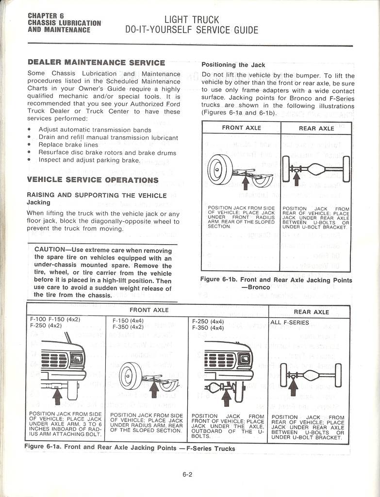

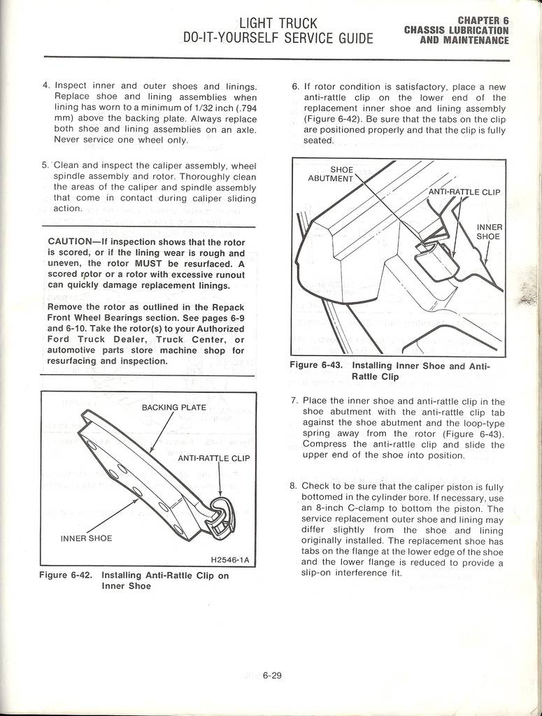

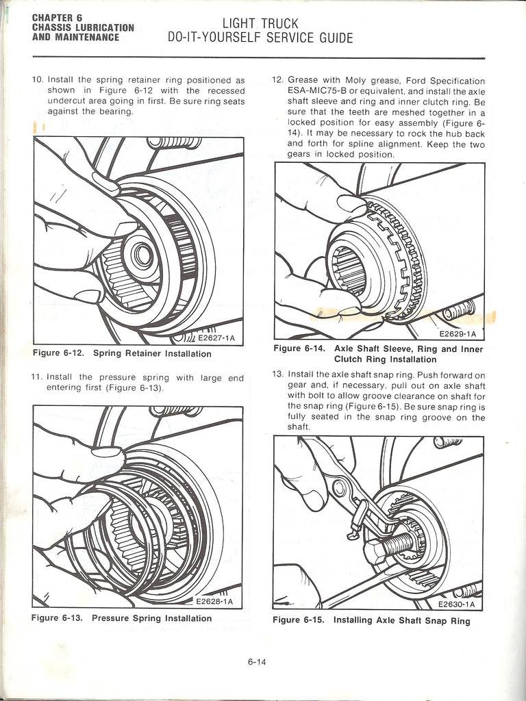

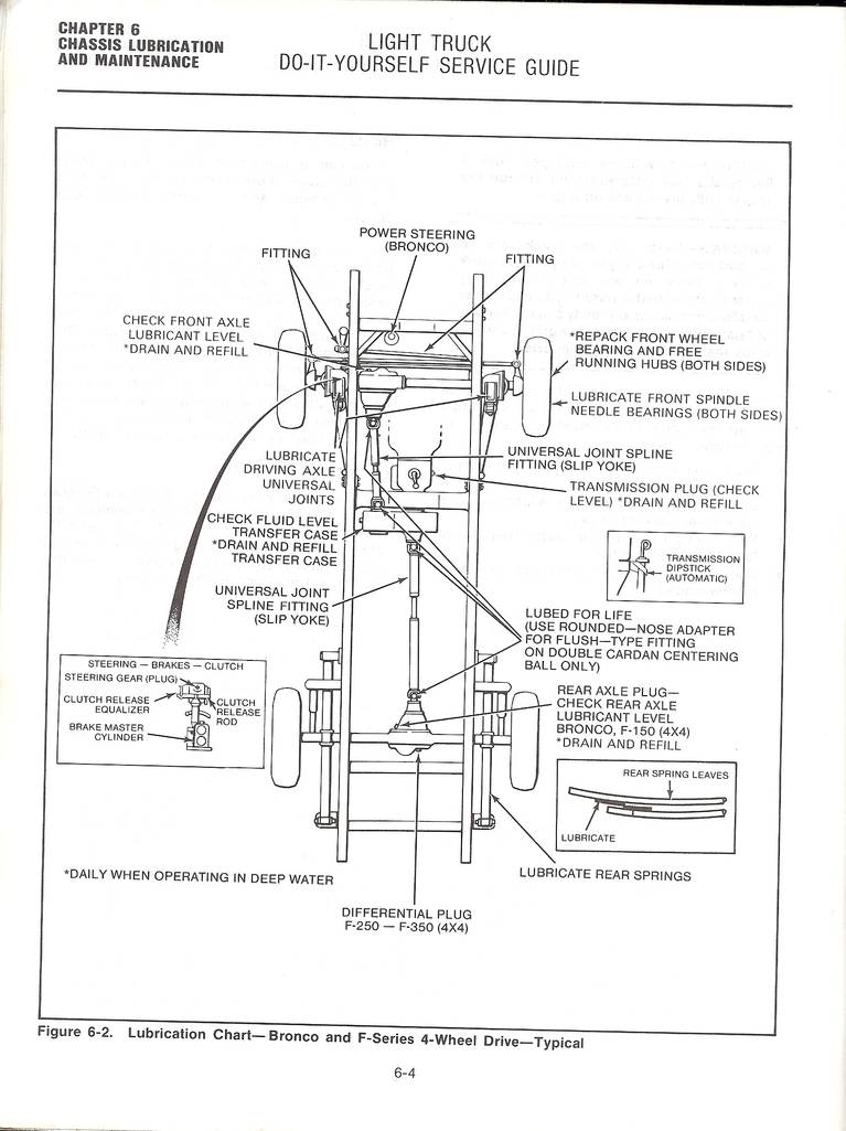

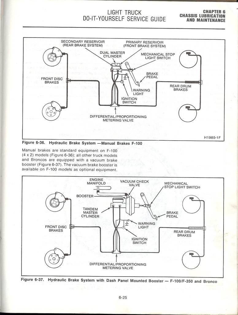

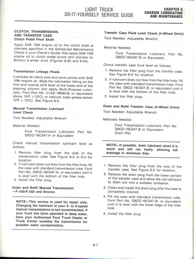

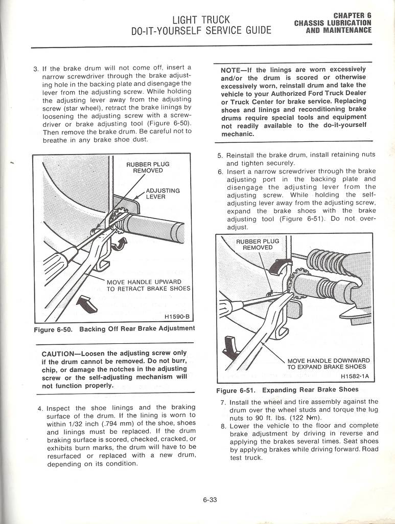

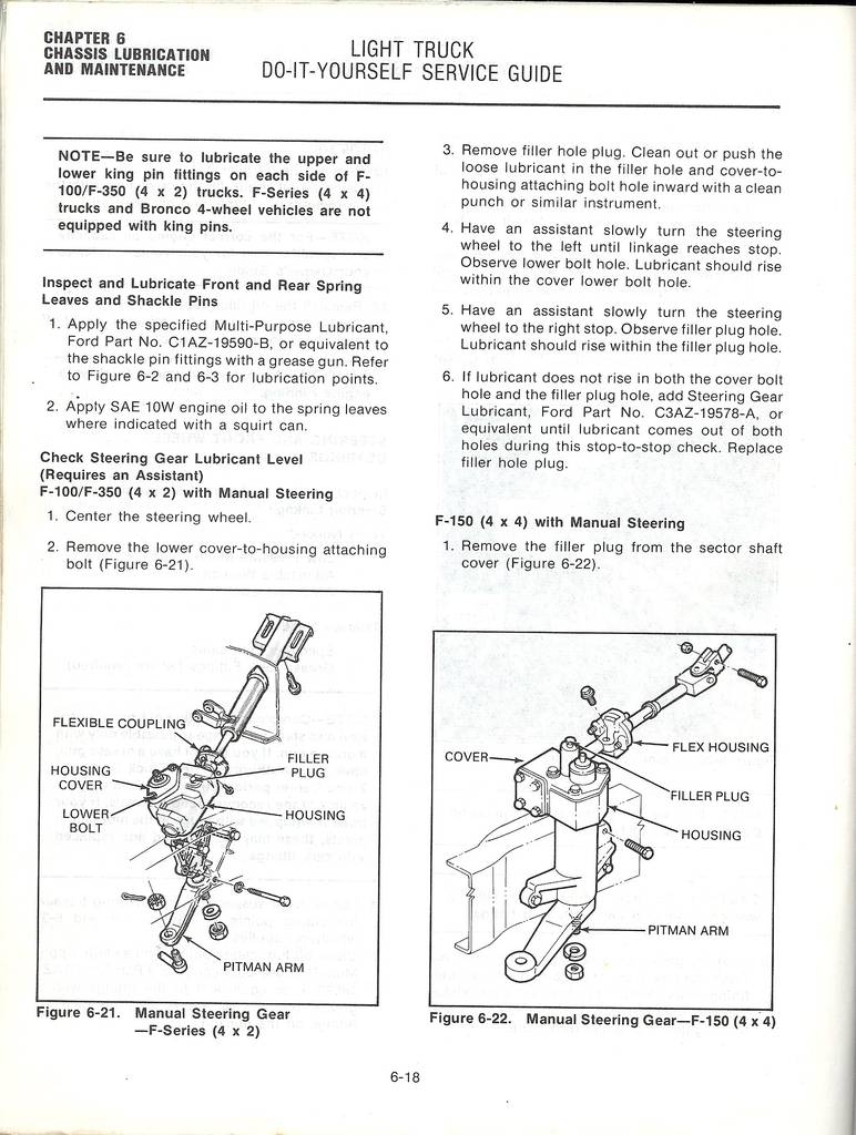

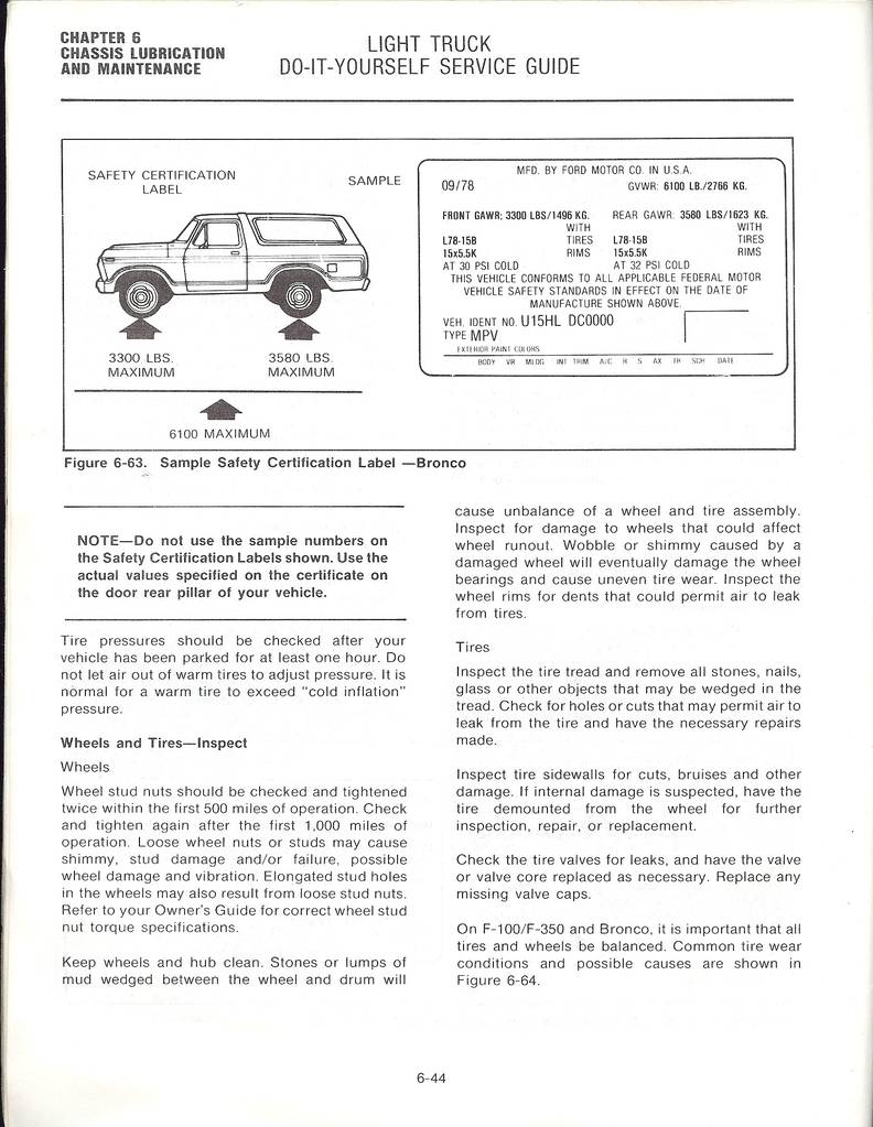

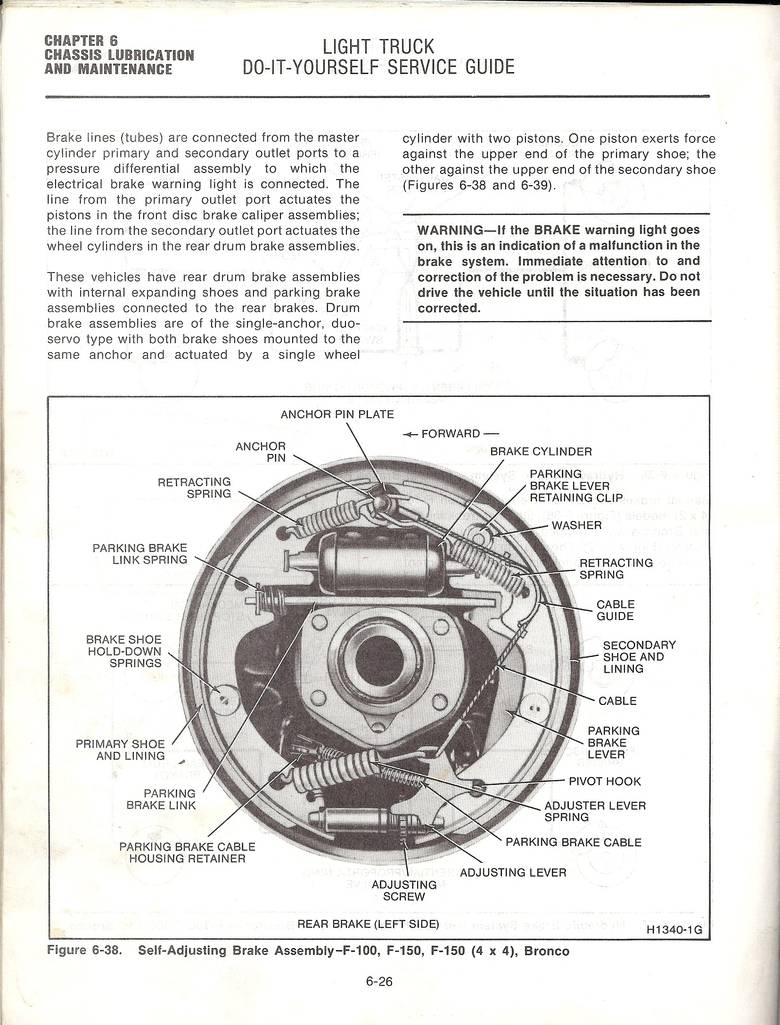

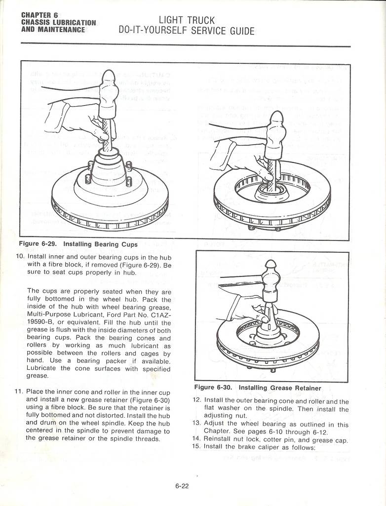

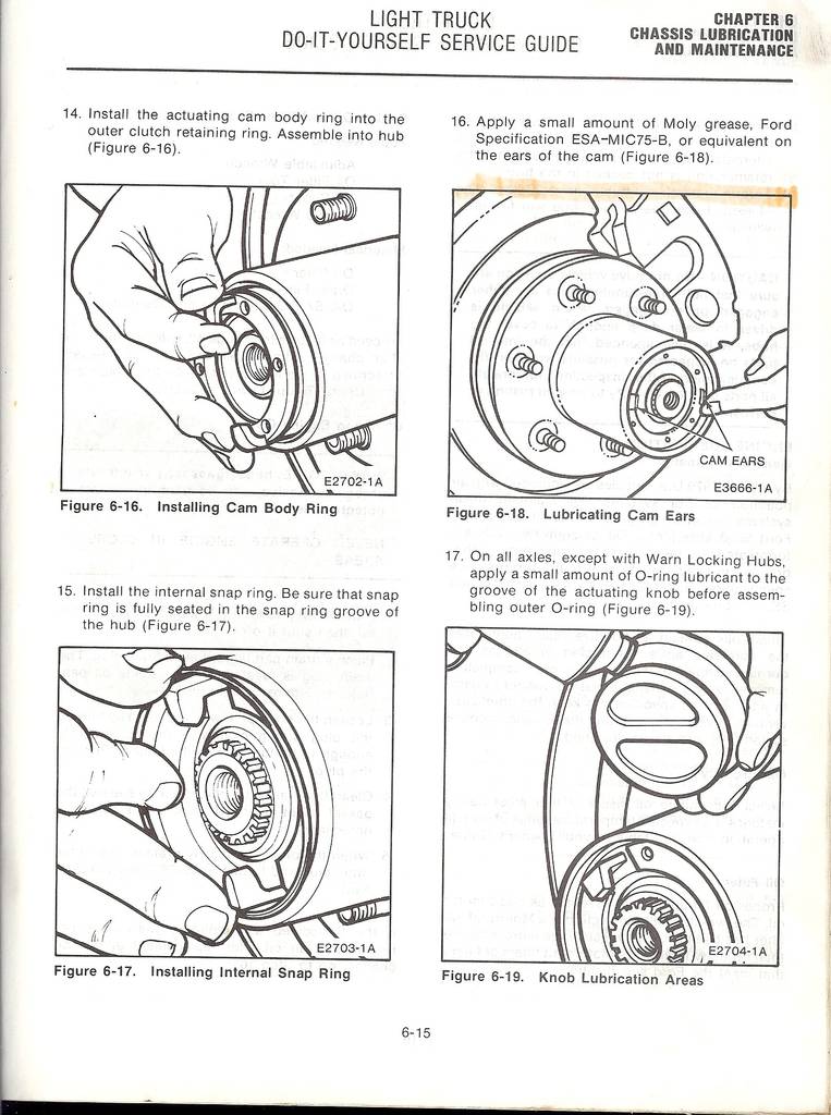

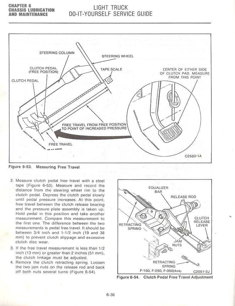

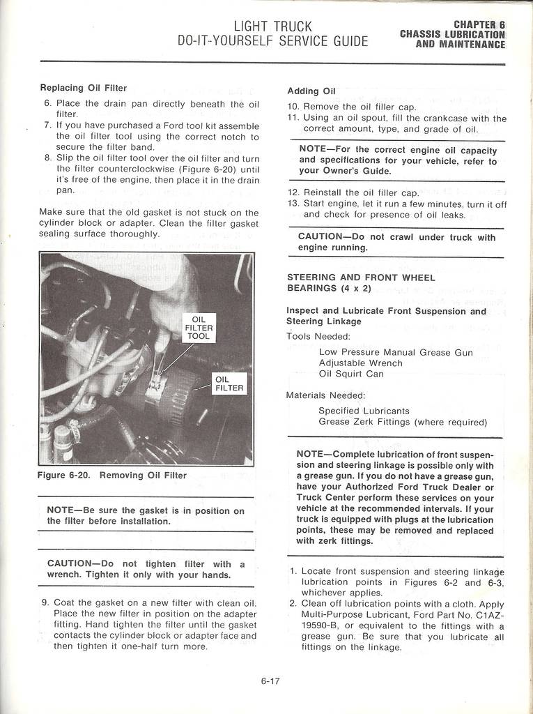

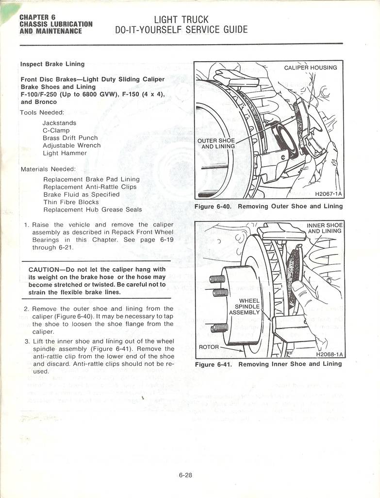

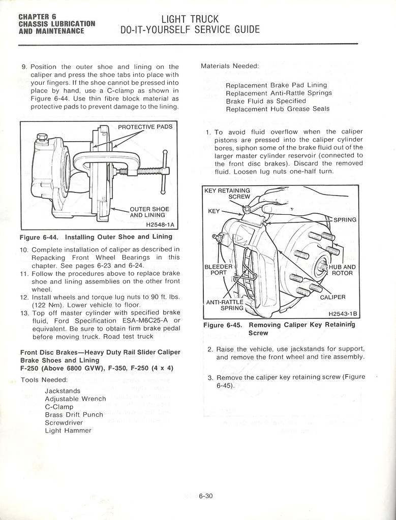

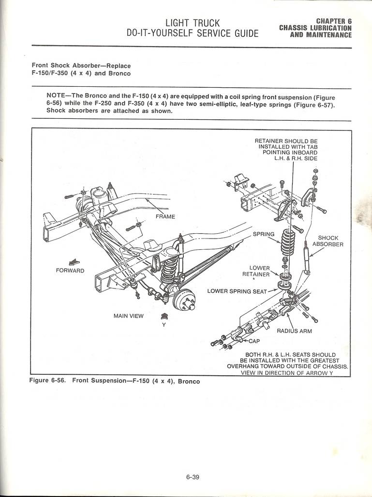

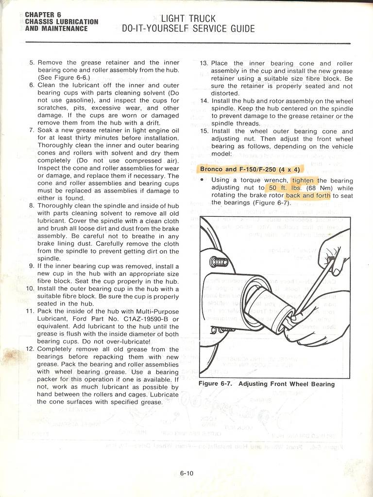

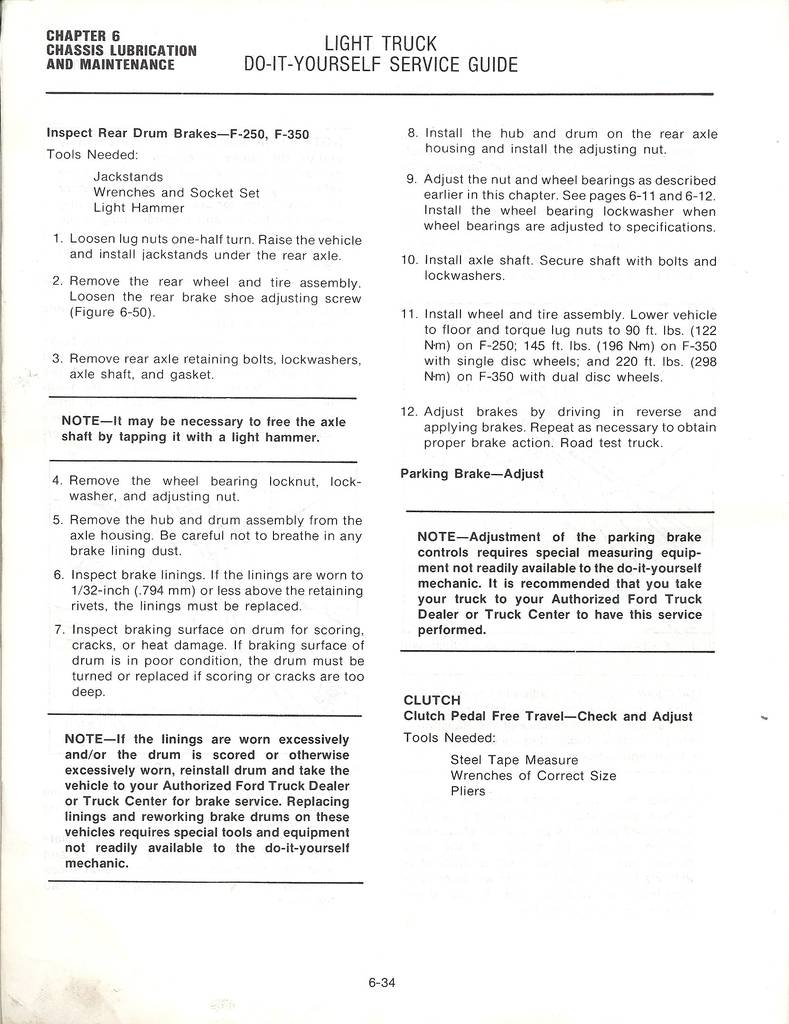

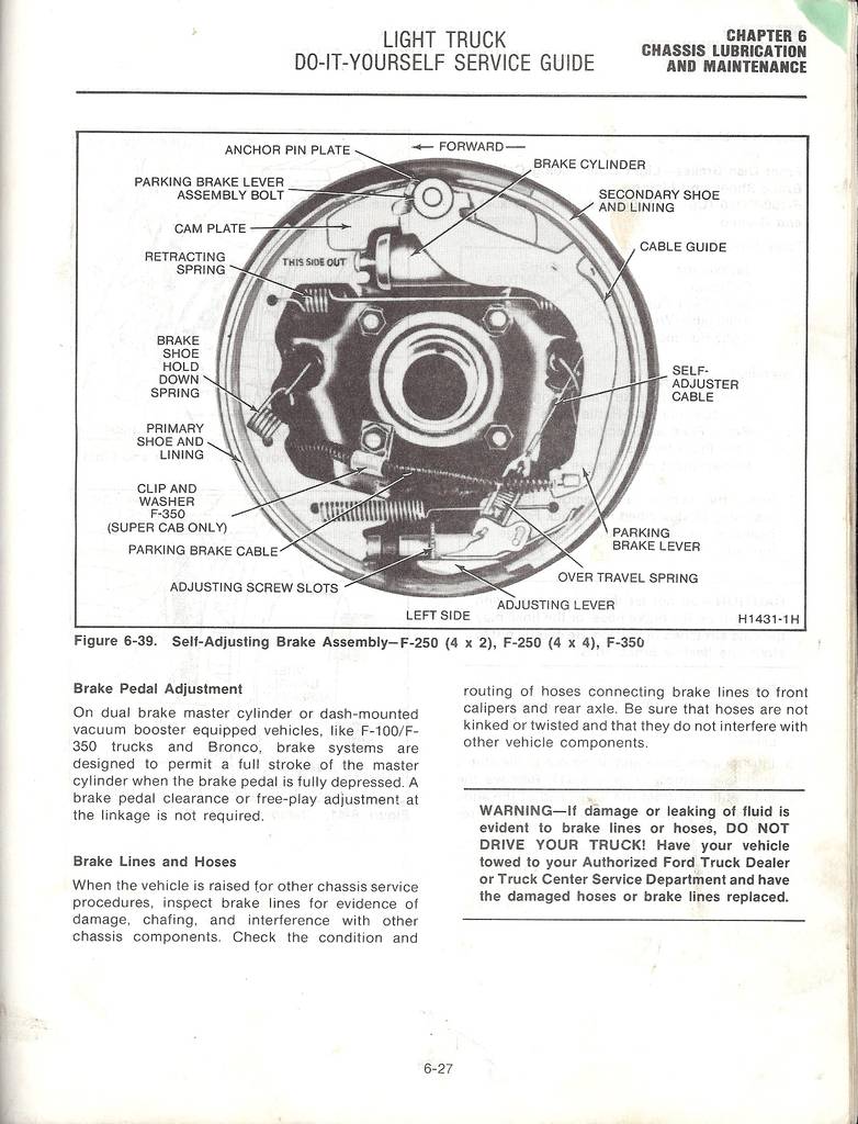

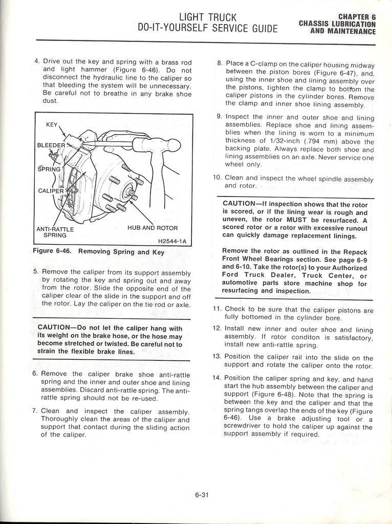

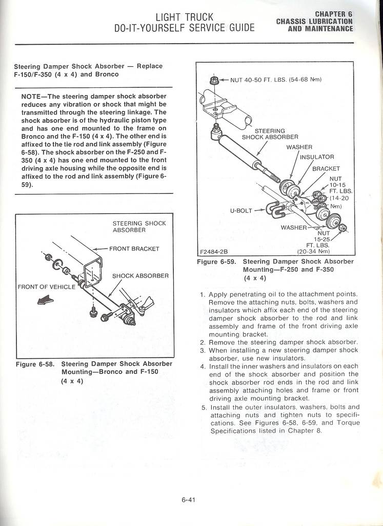

Aug 6, 2011 Moderator #4 DNFXDLIThe Token CanadianStaff member49,0831,089 The Great White North Chapter 6 (pages 1-25)

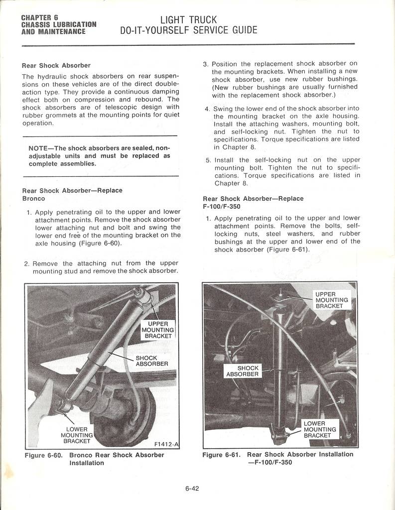

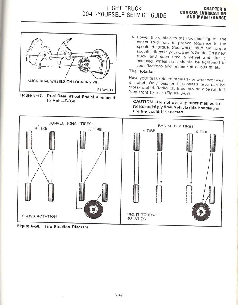

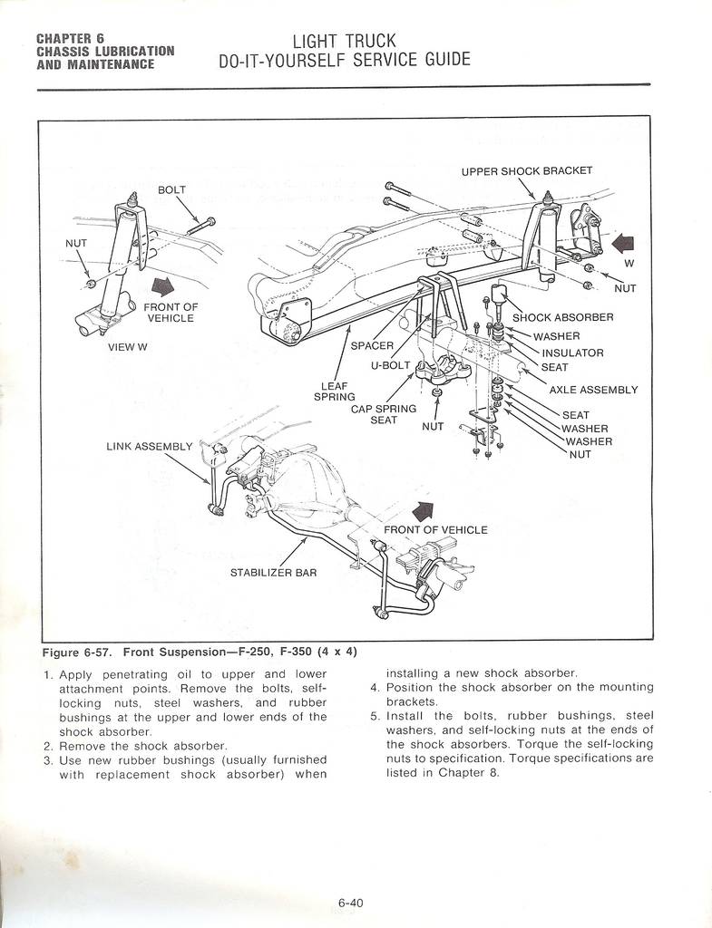

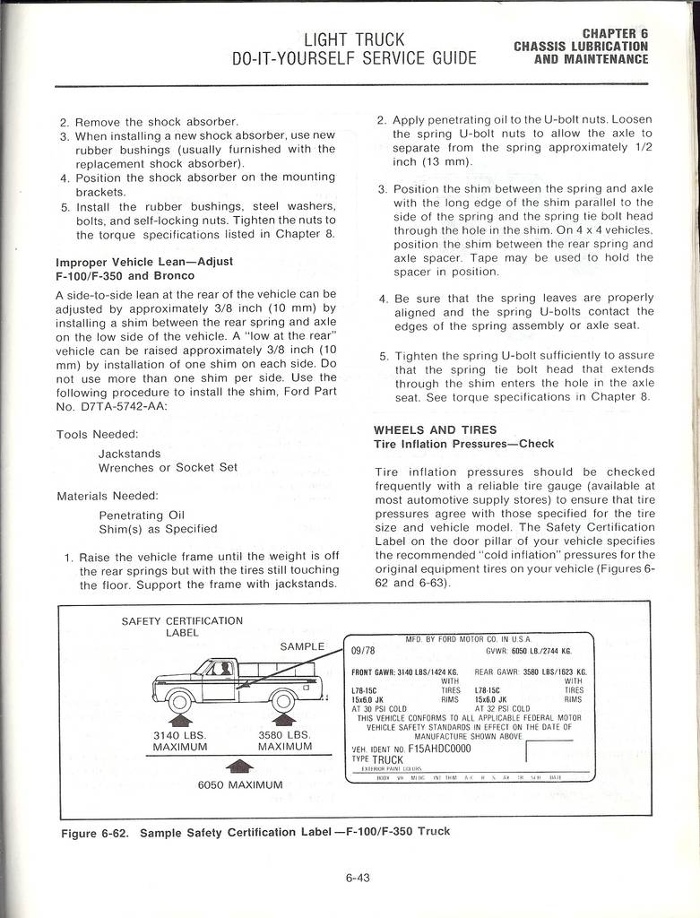

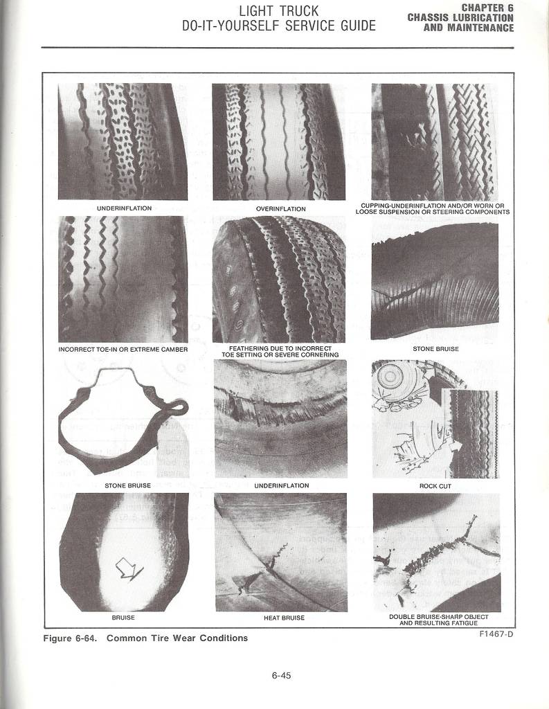

Aug 6, 2011 Moderator #5 DNFXDLIThe Token CanadianStaff member49,0831,089 The Great White North Chapter 6 (pages 26-end)

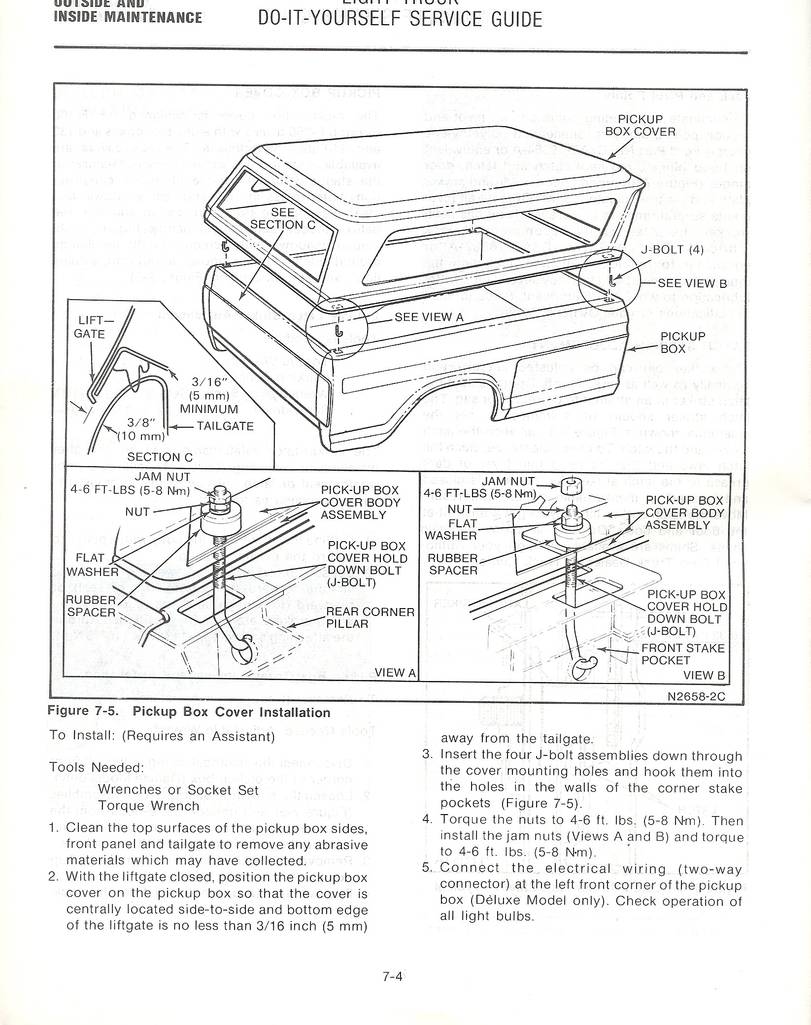

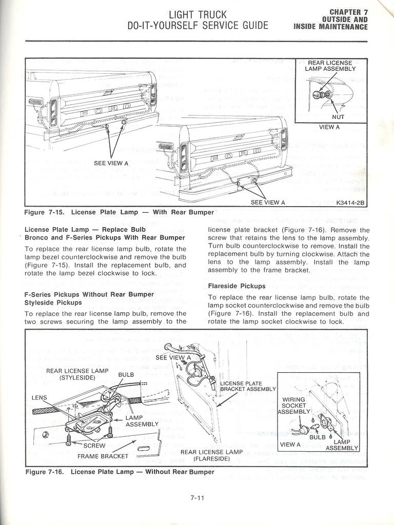

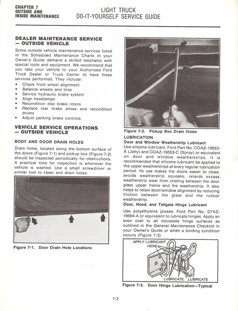

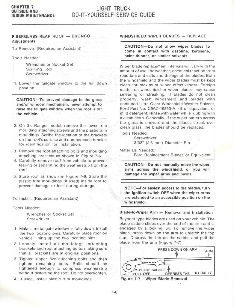

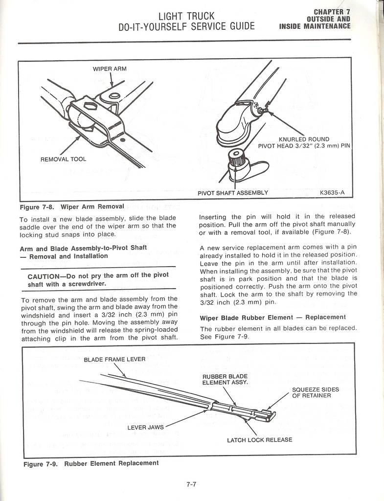

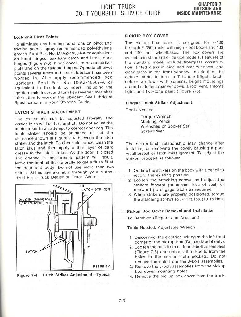

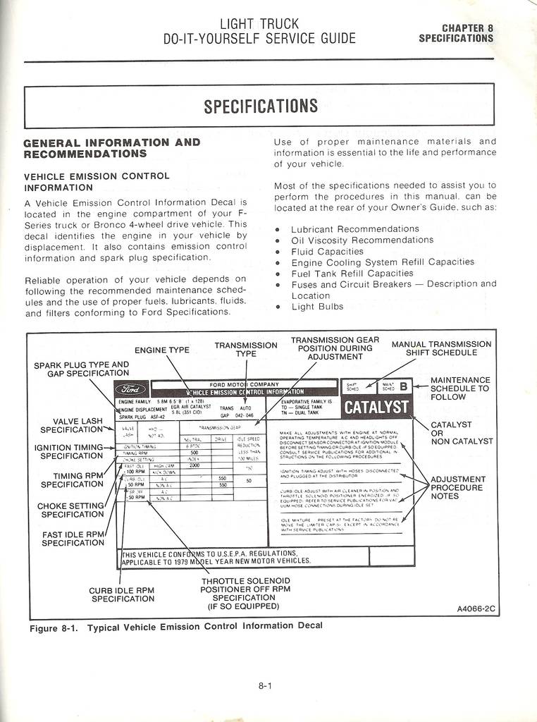

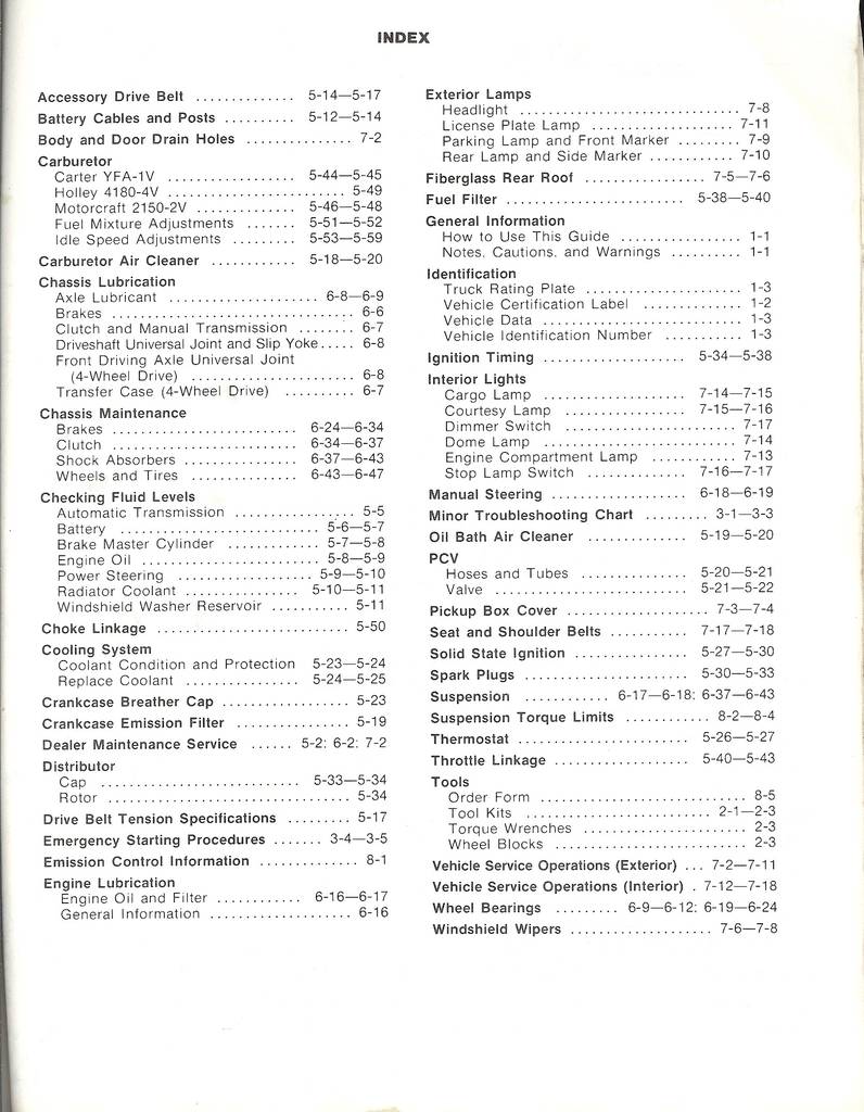

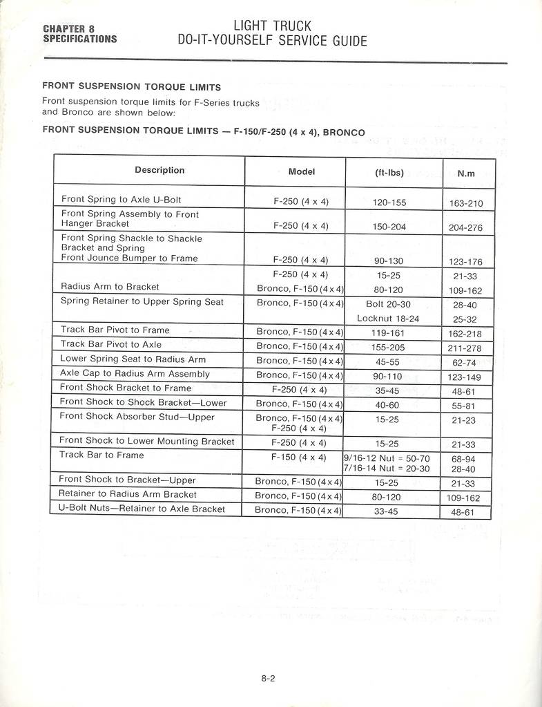

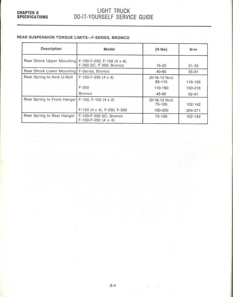

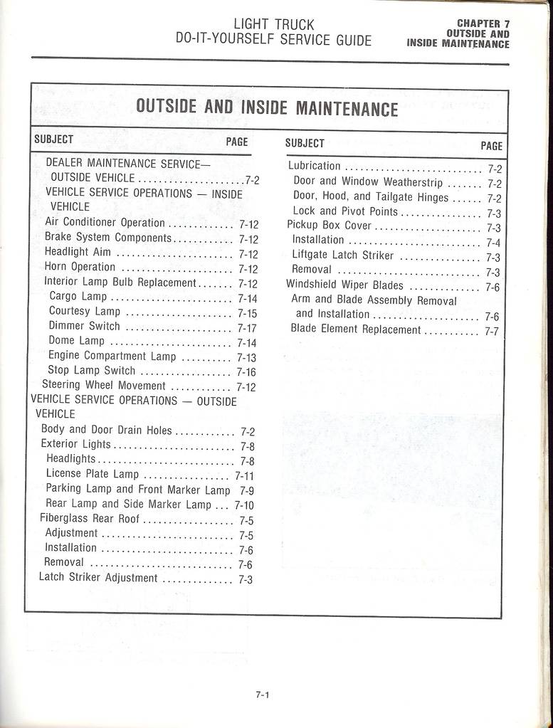

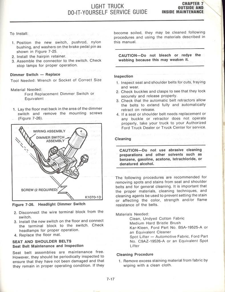

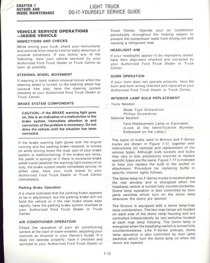

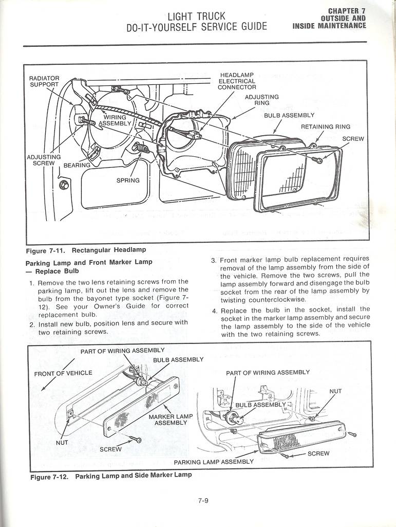

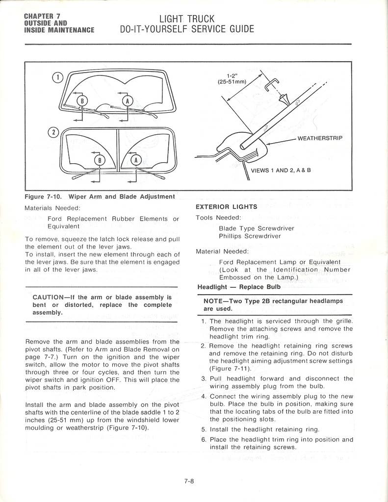

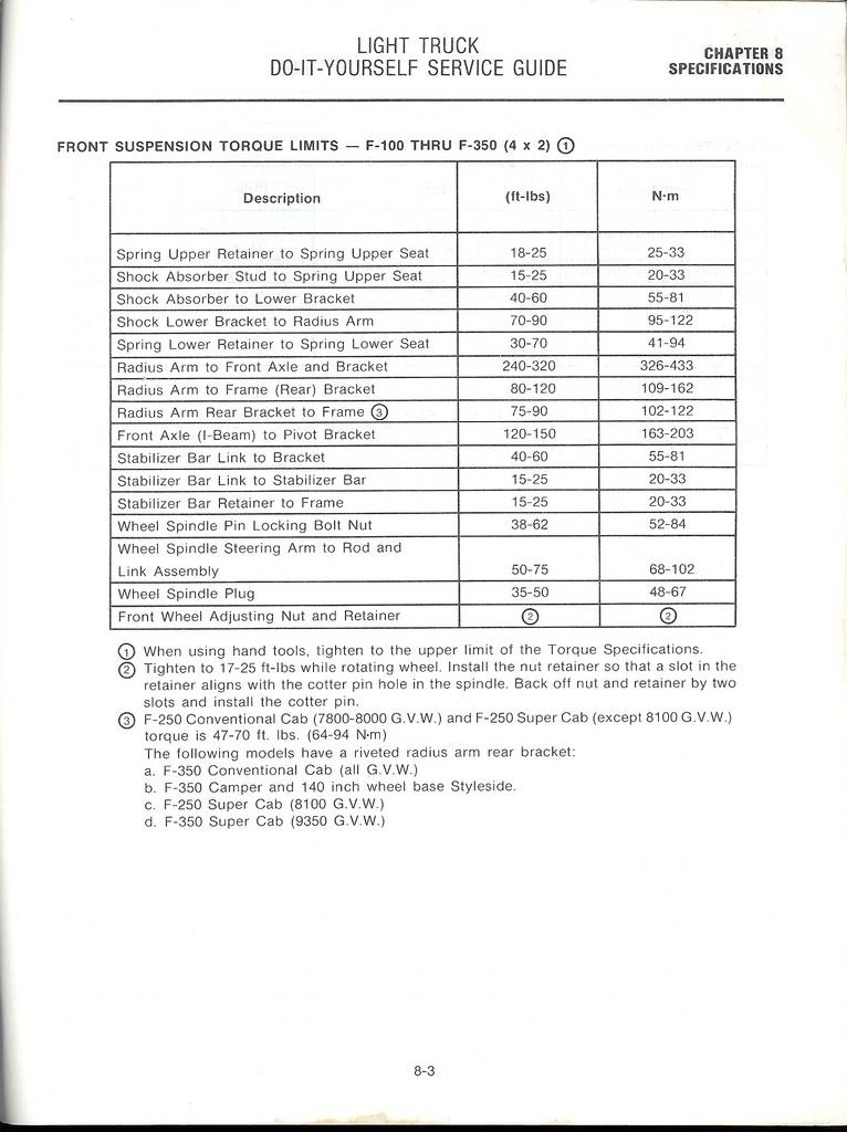

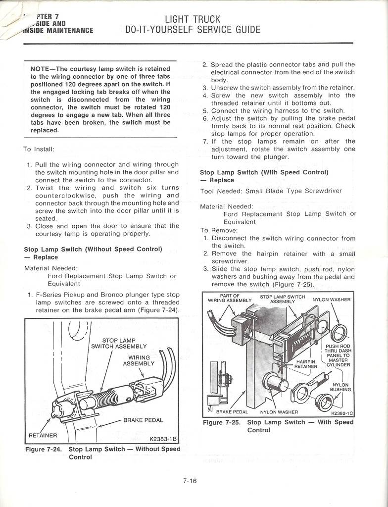

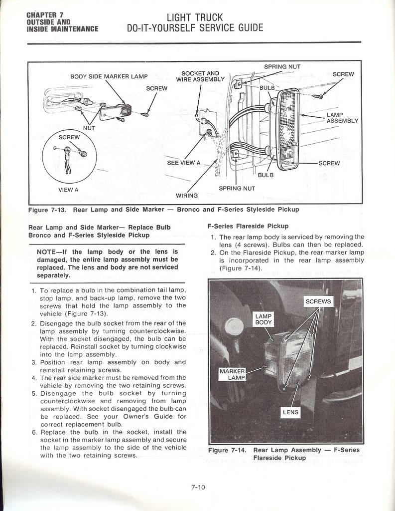

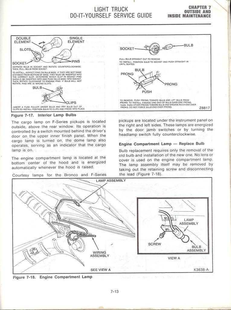

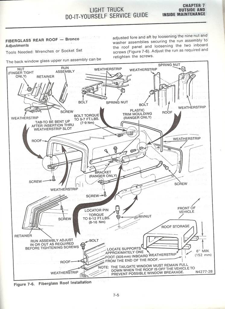

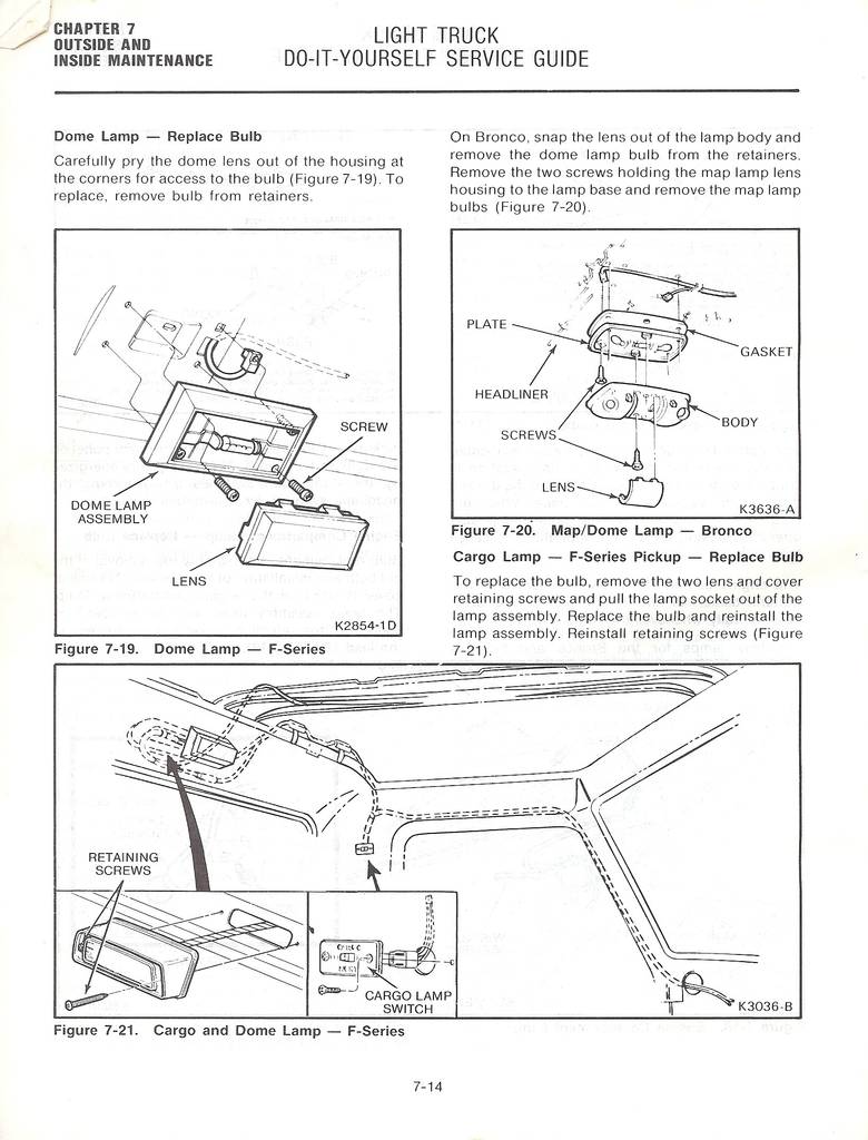

Aug 6, 2011 Moderator #6 DNFXDLIThe Token CanadianStaff member49,0831,089 The Great White North Chapters 7, 8 and index.
