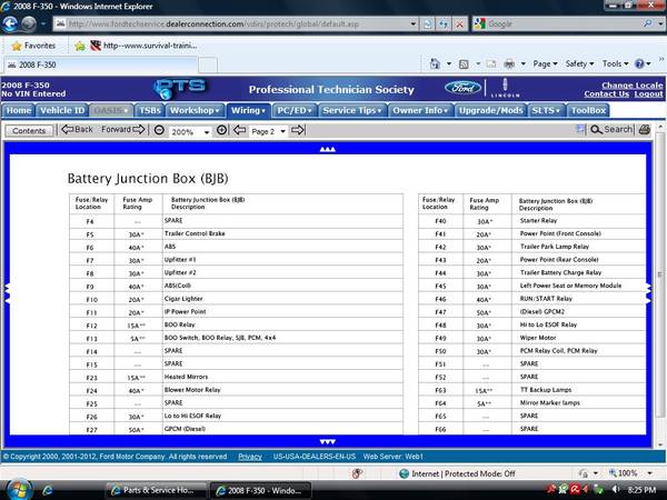

Need to know which fuse to replace for the trailer brakes. Thanks,

F5 battery junction box (under the hood)

Thanks, Where is the F5 located in the battery juntion box?
